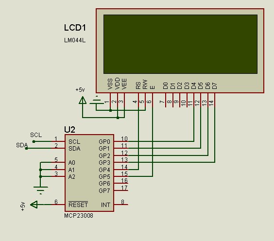

Hello
I'm still using "Customize Component Code" (only for Flowcode v4)
I'll post the code soon.
There'll be all the usual "Component Macros" with an I2C management.
I use a classic LCD with a GPIO (from Microchip) : MCP23008.
The only rule is to respect the schematic below.
Daniel

How to use I2C LCD.
INTRODUCTION
I2C bus is very interesting cause it needs only 2 lines of the micro-controller.
You can find lots of components (RTC, thermometer, Led dimmer, …).
The bus frequency is 100kHz, writing a register will take about 300us.
It could be a bit slow for some components, but for some others it is quick enough.
I was working with an RTC (DS1307) and needed to display the time.
Using a classic LCD will waste 6 (or 10) pins of my Pic and a real I2C LCD was expensive enough
Then I decided to use an I2C GPIO (MCP 23008) from Microchip.
For me, the code customization with version 4 of Flowcode is very interesting cause all the code stays with your Flowchart.
On top of that, I wanted to use this new component identical to Matrix_Multimedia (with simulation).
End of chat.
TECHNICAL
For hardware the only rule is to respect the schematic given above ( close to the one given by Matrix M in the LCD help)
For the Software,
Choose your LCD as usual (2x16 , 4x20,…), the macros are identical (and simulable).
The supplementary thing is to add a I2C component and to add the macro I2C "Init" BEFORE the LCD init.
Note : I2C is only "Hardware" , the software mode is not supported (it could be).
Note2 : It is not necessary to provide a port for connection, if you leave "unconnected", when you compile, you will get 2 warnings which tell you "some components are not connected" but everything will go well.
Remarks :
- I have done the same thing with a PCF8574A and a real I2C LCD (BATRON BTHQ21605AV-YETF-LED04-I2C from Farnell , a little detail : the char set is not standard)
- You can do the same thing with the keyboard.
Daniel
PS : thanks for the feedback

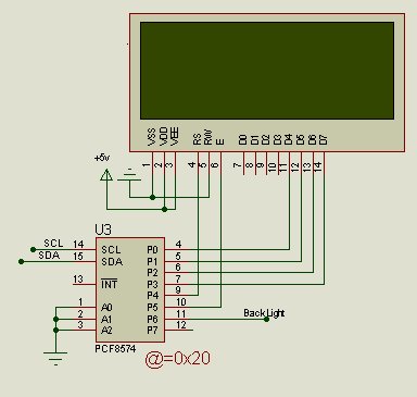

Hello Bercioiu
The same flowchart as above but with a PCF8574A.
Daniel
Daniel

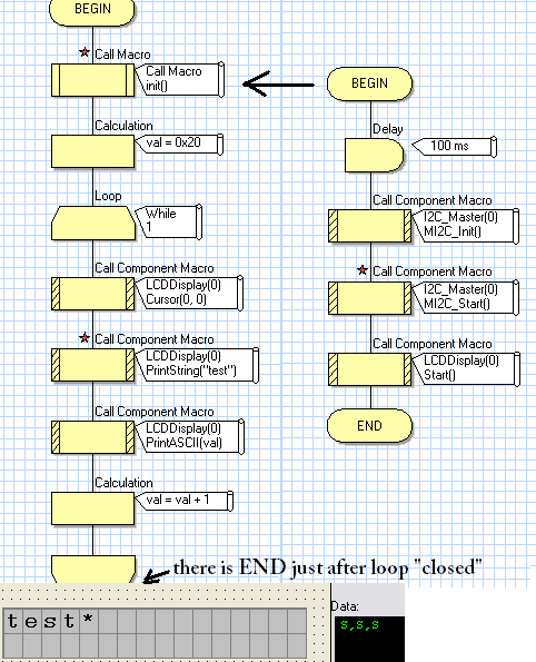

Hello Dan. I'm trying to control i2c LCD with PCF8574 but on Atmel AVR (atmega168) MCU.
I managed to open LCD-I2C-PCF8574a.fcf in Flowcode AVR 5.3 to see basic commands. I realized the main substance of "code" but there is one thing that I don't understand at all.
Physical Connection of LCD ?! That LCD (your is 20x4 and mine is 16x2, anyway standard) should be connected to I2C pins of MCU, ( in my case those are 27-SDA and 28-SCL), Vcc and GND, 4 wire total, and as far I understand those should be the only 4 pins used for LCD. I have 4 pin IDC connector for i2c with those 4.
But when I opened LCD-I2C-PCF8574a.fcf under LCD connections I saw that almost entire PORT B is used ?!
From PB0-PB3 for data bits of lcd and PB4-RS and PB5-EN.
During Simulation I see on "view chip" that states of those pins are being changed from LOW to HI, randomly.
Question is What to do with those ?? I need those pins of PORT B for something else, those are my "inputs on plc board" and I can't allow their state to change without any signal on real inputs, I need those pins completely free from lcd controll .
If I "remove" those connection of LCD to Port B in Flowcode I get warnings and error during compile?
I have not made any real hardware for LCD yet, until i get anything logical in simulation , main MCU board is finished and tested for everything else except I2C communication to others "slaves"
// sorry bcs my probably bad english
- Dan81
- Posts: 268
- Joined: Sun Jan 15, 2006 4:07 pm
- Location: Albi France
- Been thanked: 60 times
Re: 3C : LCD I2C
Hello Milek
Customisation was made for Flowcode v4 (different with Flowcode v5).
Connections to portB are not really made (it is a I2C bus) .
You can move connections to "unconnected" and the compilation will be OK with Flowcode4.
If you can manage a LCD with C code, it is enough easy to manage it through a PCF (but a bit long !) .
Moving the code to Flowcode5 is not useful because Flowcode6 is the current version.
Sorry
Daniel

This part of help file doesn't tell me anything, i see it's "example" for some memory chip but any way i don't know what to do with that, what blocks in diagram i have to use, where to put those and how to set all features.
I made one diagram based on Dan81 example.
Result: Simulation-ok , LCD ( in simulation ) show what i wanted to see, simple word "text" and then characters behind. Compile to C-OK, compile to .hex-OK Problem: as in my first comment i saw that states of pins on POrtB are being changed (view chip) , Dan said "Connections to portB are not really made" but i just sent hex to mcu and because i have some LED's attached to PortB i see they are blinking, ( I didn't made i2c board with that 8574 chip until i get something that could work ) so connections to portB are really made. If disconnect LCD from portB (in flowcode), simulation still work but with warning about unconnected device, compile to C-ok, compile to .hex doesn't work.
I'm really desperate about this. I understand it should be probably easy but for someone who understands the issues and I'm not in this story.
I wanted to attach that diagram files but it's on my home pc but i saved some *screen shoots* on my flash drive,

- I put together three screen shoots into one image
- 1slika.jpg (401.39 KiB) Viewed 47011 times

hello Dan81.
It was some time ago since I visited this forum (and used FC at all) last time and i was happy to see the answer
I have tried simulation and build hex, both works now, on pc and hex is generated, but my problem also is hardware check, the wiring of my pcb it's not same as matrix multimedia lcd and little schematic you have posted earlier in this thread.
address 0x20=Ok, connections for data bus d4-d7 lines=OK, RS pin of lcd=OK, but my RW is connected to p5 and EN of lcd to p6, backlight to P7 (npn transistor)
i just need information where in custom code to find that part where i can change order of connection between PCF and LCD because my pcf8574 is smd chip and i have no any other way to make changes except in code. cutting my pcb traces and soldering wires arround doesn't look as option.
chip configuration and quartz frequency , no problem ,they are already same
EDIT: TODAY i took my pcb and looked around , changes on board were minimal so I have decided to make them.
now connections are same,
PCF-LCD
PO--D4
P1 --D5
P2 --D6
P3 --D7
P4 --RS
P5 --En
backlight is ON because it's connected to Vcc and gnd.
a2,a1,a2 are all tied to GND so address is 0x20, everything ( I think) as it should be but something is not OK. on my LCD just after power up first row of 16 is filled like in picture attached (it's not my picture, i have just find it on internet because it's same issue as mine)
PCF-LCD
PO--D4
P1 --D5
P2 --D6
P3 --D7
P4 --RS
P5 --En

Re: 3C : LCD I2C
Hello Milek
Have you put pull up resistors on clock and data lines ?
Which hardware are you using ?
Daniel
Daniel
Re: 3C : LCD I2C
Check the requirements of the contrast pin3.
For other LCD's I have used the wiring pin3 direct to the supply pins will often not work.
Place a 10k preset between +5 and GND and take the wiper to pin3. As you adjust the setting it should go from all pixel black to a blank display, and somewhere in between the characters 'may' burst into view.
Re: 3C : LCD I2C
Yeap, there are pull-up on scl and sda but 3,9k, i hope it's fine bcs i don't have higher values at this moment but there are still pull-up's, maybe i could add to them one more in series to get 7k8 for both data lines?Dan81 wrote:Hello Milek
Daniel
I'm using my own design, a board with ATmega168 ( internal 8mhz). Everything else (mostly very simple stuff) i have tried on that board is working except i don't know how to use i2c
I was also looking for some finished hex code for atmega 168 (or atmega8) just to burn it to mcu and check is my pcf8574 board is ok at all and i have found this http://mmdolze.users.sourceforge.net/us ... h-twi.html it has same wiring except back light where mine is npn transistor and not pnp BUT there is no hex included and i can't get it no chance.
I thought of it so that part is 100% ok, i have some other board with tiny2313 programmed just to scroll text around on LCD (standard 4b parallel connection) and contrast on pin3 is adjusted to be ok. Then I switch my lcd to PCB With 8574 and get those square like from picture above but they are visible because i set same value of POT on both boards.KevinH wrote:Check the requirements of the contrast pin3.
