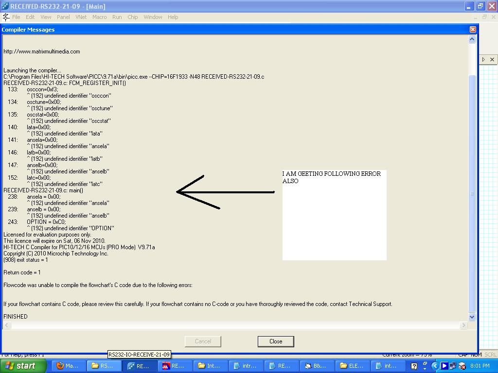

hello
presently i am working with PIC 16F1933 micro controller , but PIC16F1933 microcontroller it does not working with default BOOSTC compiler,
I have following query about PIC16F1933 MICRO CONTROLLER flow code programming,
1)Why PIC16F1933 microcontroller flowcode program does not compiling using default BOOSTC compiler,
2)Again purchasing HITECHC compiler it does not worth for me,because HITECH-C compiler evolution version for 45 days, All my development is going on using 16F1933PIC microcontroller, please tell me the alternative solution for compiling and programming for 16F19333 micro controller ,

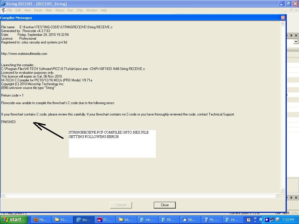

3)BUT When i was compiling FLOW CODE PROGRAM into HEX file getting ERROR, FOR YOUR KIND REFERENCE I HAVE ATTACHED COMPILER-ERROR.JPEG FILE AND COMPILIATIONERROR.JPEG FILE,, But it will generate C code,
4)Generated c code downloaded into into PIC16F1933 microcontroller using MPLAB working environment, but development board does not working properly,
5)please send me the updated 16f1933 FCD file for pic16F1933 micro controller using default BOOSTC compiler,

This chip is not currently supported by BoostC as are a lot of the newer PIC devices. We hope to update the version of BoostC in the next update.1)Why PIC16F1933 microcontroller flowcode program does not compiling using default BOOSTC compiler,
The free version of Hi Tech works with all the newer chips so we made Flowcode's code compatible with HiTech. There should be no need to buy the HiTech compiler.2)Again purchasing HITECHC compiler it does not worth for me,because HITECH-C compiler evolution version for 45 days, All my development is going on using 16F1933PIC microcontroller, please tell me the alternative solution for compiling and programming for 16F19333 micro controller ,
Some of the newer chips are currently missing HiTech compatible Flowcode definitions. I will try and sort this out early next week and offer you a solution.3)BUT When i was compiling FLOW CODE PROGRAM into HEX file getting ERROR, FOR YOUR KIND REFERENCE I HAVE ATTACHED COMPILER-ERROR.JPEG FILE AND COMPILIATIONERROR.JPEG FILE,, But it will generate C code,
Can you specify what is not working? Could it be your configuration settings?4)Generated c code downloaded into into PIC16F1933 microcontroller using MPLAB working environment, but development board does not working properly,

Here is an updated definition set for the hitech compiler that should allow all the newer devices to function correctly with Flowcode.
Make a backup of the definitions.h file in your "Flowcode v4/FCD" folder and then replace with the updated file from the zip.

If anyone gets this message....
It seems HiTech has renamed some of the "option_reg" registers to "option".
PIC16F1933 for example is now working correctly
Then this can be fixed by using the supplementary code window via the View -> Project options menu and adding the following definition.option_reg = 0xC0;
^ (192) undefined identifier "option_reg"
#define option_reg option
