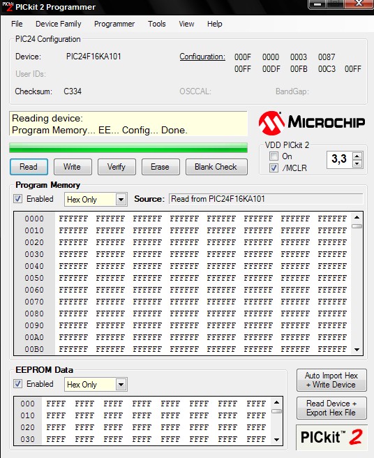

But the programmer is well connected to my board and I can read the microcontroler with the pickit 2 software, I can erase it etc etc so the electric connection are OK.

The target and busy LED stay off. When I use the pickit 2 software, everything goes well but there is a problem of fuse.

If I use the pickit 2 programming software, I always have the message I described on my first post.
I attached a picture.
