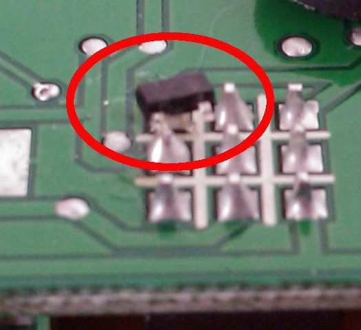

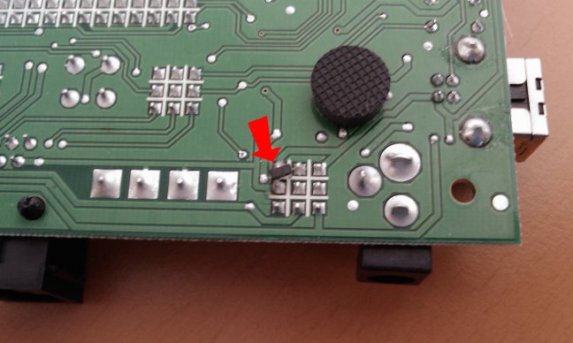

Looking at the solder side of the programmer, I saw a "piece of plastic" between two pins. Taking a closer look, this isn't plastic at all - looks like a smd component which has been soldered between two pins. Some sort of intermediate patch? Please take a look of the attached photos.
Doesn't look good and I'm afraid that this programmer is broken (tried same settings as with rev.6). Yellow LED (USB connection?) lights up when power supply is being connected.
What to do next? Please help, thank you in advance.

Not sure why your programmer isn't working. but I can assure you the SMD component on the back of the board should be there.
See my previous post

The SMD component underneath the board was retrofitted to get around a problem that was causing the microcontroller to stop running when the USB cable was not connected.

I have an EB006 board Rev.7. it has the SMD component ( or did) on the back of the connector. On further inspection one side of the component has detached from the pin and the component lead has sheared off at the case making it impossible to re attach.
I suspect that this component is a diode (one side of a transistor package) used to bridge power to the CPU in USB mode, am I correct? I would appreciate confirmation and the orientation of the component so I can replace it with a discrete component.
many thanks.

The device is a fairly low current schottky diode. It is connected to the bottom left hand side of J29 when looking from the underside. The diode's anode is connected to the bottom middle pin and the cathode is connected to the bottom left pin.
