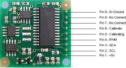

My latest project is a electronic digital compass.
While browsing a component site, I spotted this interesting module.
CMPS03 Compass Module.
Fig1. The PCB as received from the supplier.
North is at right angle to the left side of the pcb.
The 2 x 8 pin chips nearest the left side are the Philips KMZ51 magnetic detector devices.
Data sheet for the compass can be downloaded from here.
http://www.robot-electronics.co.uk/htm/cmps3tech.htm

The unit must be used horizontally or on a flat surface non metallic surface, serious errors will be introduced if these recommendations are not followed.
The unit consists of a small PCB (approx 35mm square), fitted with a SIL header plug. This has standard spacing allowing it to be plugged into a standard protoboard.
The functional part of the circuit is 2 Philips KMZ51 magnetic field sensor IC’s mounted at right angles to each other. These pick up the earth’s magnetic field and can calculate the direction the unit is facing.
Module Calibration
It is recommend to ensure the unit is working properly before attempting calibration.
It may be necessary to calibrate the unit.
A standard magnetic needle compass is needed to do this.
The module is positioned to point to the 4 main points of the compass (N E S W)
At each point, a value of 255 is written to the module via the I2C bus
Alternatively it can be calibrated by connecting the cal input (pin6) to ground (pin9) by a push switch.
This way will be fitted to the final version using a jumper to allow the button to be totally disconnected from the module when not needed, this will prevent it being pressed accidentally and corrupting the calibration.
This method is preferable to using the I2C bus method as it allows the unit to be recalibrated in the field where access to a pc may not be possible.
As above the unit is calibrated at the 4 main points of the compass, the button is pressed momentarily to set the value before being moved to the next position.

A couple of important points that were missed of the first post.
1.)The SDA & SCL lines need a 1k8 pull up resistor to the 5V line. See data sheet for more information on this.
2.)If buying a module ensure it has at least version 14 firmware.
This can be easilly checked as earlier versions have a ceramic resonator on the board. V14 and up just have 3 solder pads.
