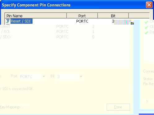

Hi Zane,
Can you select the component, right click and check the connections as as shown below and that the port matches the port you have connected the display to.
You should also check that the jumper on the board is set to low to match these connections.

Re: V4.5 Graphical LCD module no longer works
Hi Ben,
My apologies, i have just checked the connections and instead of how they usually default to porta in the configuration shown, they were different. I have changed them and now the screen will initialise.
I still have an issue though. When you draw a box and make it a solid object there is the outline of the box and then a smaller solid box inside of it offset to the lower right of the outer box, hence having a line of the background colour going up the left hand side and over the top of the box.
Thanks for your help. I'm very impressed with the support from this site.
Zane

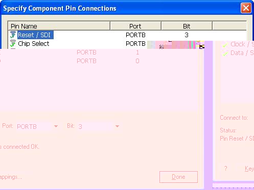

Hello Zane,
Ok using the v4.5 gLCD component C file I have tested the EB043-00-1 board and the text is printing out correctly.
Please can you check your component connections for the gLCD and ensure they are as numbered here if using the Low jumper setting.
