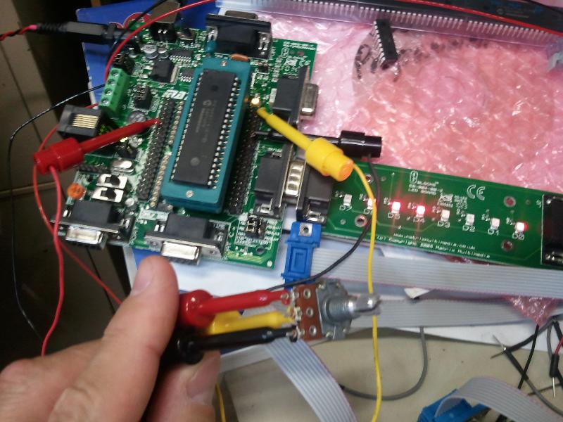

Great link Martin very helpful!! The chip configure gets me every time. I made the changes that you suggested thanks. I am still not getting the hook up of my potentiometer? The way I have it now is Vdd and Vss going to the outer pins on my pot (with jumpers) with the center pin going to pin 2 on my chip (16F788A). My thinking is that I will vary the voltage 0-5 going to the analog input that will give 0-255 byte in the program? I am getting some change with the LEDs but not what I am getting with the simulator? One other thing Martin in the link you were talking about the MCLR or Master Clear Enable? There is no option for this when using the 16F877A chip right? Thanks for the help!!

Re: Analog Example not working for me?
The connection points you are showing in your picture are incorrect, can you connect the points to the actual chip's legs rather then using the expansion headers?
I would connect up like this.
Black Wire - GND Screw Terminal
Red Wire - +V Screw Terminal
Yellow Wire - Pin2 of uC or Pin 1 or the PortA D-type
Ben I did what you said and lo and behold it works like magic!! Thank you Ben ,Martin, and Allpic so much!! What you suggested Ben is the way I originally had it hooked up but I think it was a combination of other problems in the chip configure that had me chasing the wrong solutions and switching my connections. From sad to happy in a few mouse clicks I love this programming stuff!
