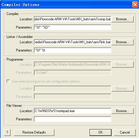

Question:
"Flowcode for ARM " software.
Why "Programmer" option is gray, cannot set.
Please help me! thank you.
Re: Question: Why "Programmer" option is gray, cannot set.
What device do you have selected in the Project Options window? Some devices eg the ECIO have hard coded programmer settings in the config file and this acts to override the settings in the compiler options window.
