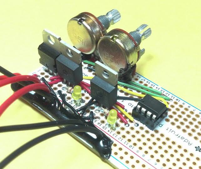

Hidaveb0360 wrote:Hi Guys,
Could I just add a footnote to your discussion......based on my own experiences today.
I had a 12F series chip lose an A/D channel today which resulted in a useless circuit that would not run code although it programmed ok.
Now I did some failure analysis and then applied some age old knowledge that I had forgotten.
Basically, I had a 1uF capacitor connected to input pin of A/D port of the chip.........to act as filter for the measurement line.....a resistive divider. After about the fifth power down of the circuit....it refused to function again.
Capacitors, as we all know, hold charge and in a power down state, the charge in the cap has to go somewhere!. It will attempt to discharge through anything connected to it....including your pic. Depending on the impedances and timings involved.....this is extremely risky for I/O ports as they can not withstand the energy discharge from caps.
Basically, although it compromises the measurement accuracy of your A/D a small degree.........always place a resistor between any capacitor connected to your precious pic ports. This will limit current flow to within safe limits and save your device.....as well as protecting ports from inadvertent shorts.
I learned the hard way.
Dave
That is quite interesting and raises a few Questions.
What value of resistor do you use?
If the Capacitor between VDD and VSS discharges slower than the one between the ADC and VSS i guess you should be fine.
But How much bigger must the one between VDD and VSS be that it will be slower? Since they do not have an equal load on them?
Of course this will only work if you apply a voltage that comes from an external source and is not fed by the capacitor that is connected to VDD.
Best Regards:
Uli
daveb0360
- Posts: 139
- Joined: Mon Sep 21, 2009 10:17 am
- Location: Leicester
- Has thanked: 35 times
- Been thanked: 12 times
Re: Adc Accuracy
Hi Uli,
I use the maximum current 'into' any pin specification from the datasheet.
This is basically defined as the maximum forward current of the steering diodes that are at the i/o pins (except MCLR).
Most pic's.....and indeed, many other logic families and processors, define this as 10mA max.
Using basic laws, this means that on a 5V driven circuit, a resistor of 500 ohms will limit current to the 10ma max. (nearest preferred value 470R)
Therefore, it would seem wise to add 470R between any I/O pin and any capacitor tied to that port. There are other factors such as capacitor type, esr etc. but as a general rule, this would seem sensible design rule IMHO.
In the case of A/D convertors, this will degrade accuracy to a degree that is related to the input current requirements of the port pin and the impedance of the preceding circuitry. This is usually in the uA range and can be largely ignored unless you require better than 12 bit accuracy.......roughly!
Dave
