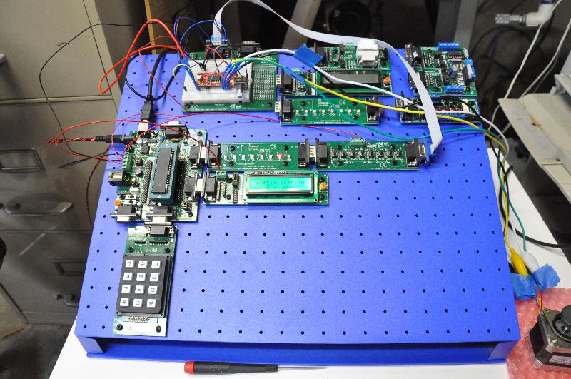

Thanks for sharing this John! Your code looks really clean! I especially like the way you do your read keypad!! I ran it to the same problem with degrees so now I just do everything in steps. I ended up cheating on my turntable project incorporating a small stepper motor driver board: http://www.sparkfun.com/products/9402 that just uses step and direction inputs. This little thing works great and is really hard to beat at only $15 USD. :D It is amazing the amount of torque you can get with this little sucker. Here is a picture of the driver board on my EB-016 to give you an idea how small it is.
Have a great day Buddy!
