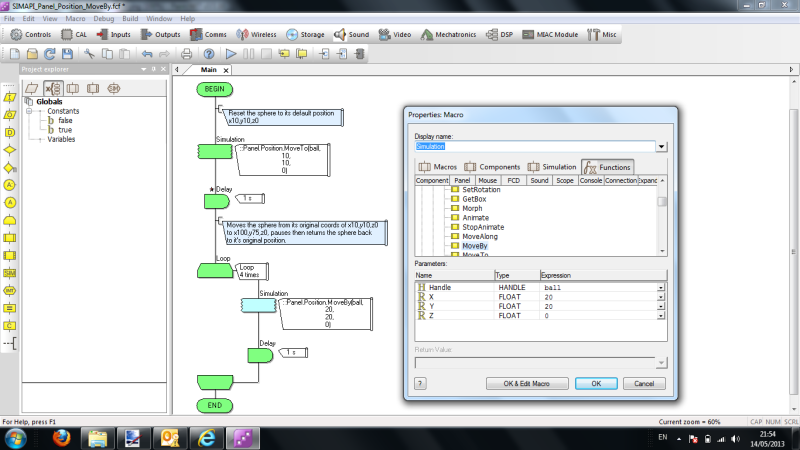

Download FC6 Icon.png SIMAPI_Panel_Position_MoveBy and open it in Flowcode v6. In this example, there are three cubiods that represent Axis X,Y,Z. Note they are coloured exactly as the panel axis indicator which represents your viewing position. There is a sphere also on the panel.

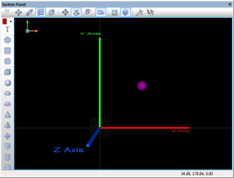

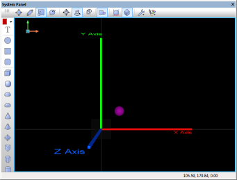

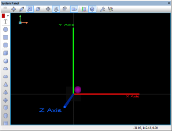

The MoveBy(h,x,y,z) function moves an object from it's original coordinates by a set value represented as an offset from it's original coordinate. In this example, the sphere's original coordinates are x10,y10,z0. The program loops 4 times, each time it calls the MoveBy function increasing the x & y coordinates by 20. This moves the sphere diagonally. As each loop passes the new coordinates would be as follows:
  1. Original Position = (x10,y10,z0), MoveBy(x20,y20,z0), New position = (x30,y30,z0)
  2. Original Position = (x30,y30,z0), MoveBy(x20,y20,z0), New position = (x50,y50,z0)
  3. Original Position = (x50,y50,z0), MoveBy(x20,y20,z0), New position = (x70,y70,z0)
  4. Original Position = (x70,y70,z0), MoveBy(x20,y20,z0), New position = (x90,y90,z0)
After each loop the program pauses a second to allow you to see the effect of the function.
The screenshots below show the effect and also highlight the code used by the example.
SIMAPI Panel Position MoveBy Pic1.pngSIMAPI Panel Position MoveBy Pic2.pngSIMAPI Panel Position MoveBy Pic3.pngSIMAPI Panel Position MoveBy Pic4.png
