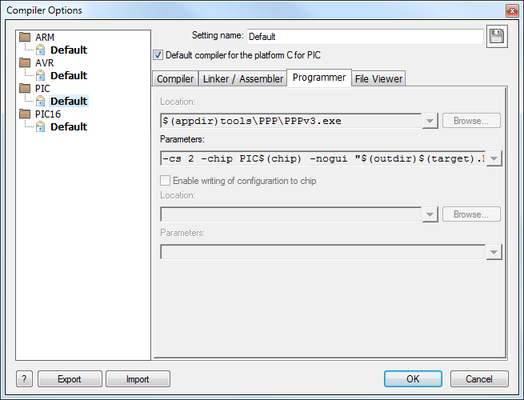

Flowcode helps you to manage different compiler settings efficiently by allowing you to save preset configurations and quickly switch between them using a dropdown menu. You can also import and export compiler settings across Flowcode installations.
Option list
The list menu to the left shows all the currently saved compiler settings (including the default settings), clicking on any of these will load the options stored under that name.
The default settings are locked and unable to be changed, you will need to create and save a new set of options to edit and configure the settings.
To create a new set of compiler options, first select the 'Save' button next to the 'Setting name:' box and type a new name for your settings. To create a new set of options select the 'Target platform:', 'Compiler language:' and choose which group to save it under, or create your own group to save it under, once these requirements have been chosen click 'OK' to save your option set.
Once your set of options has been created, you may alter and configure the settings and they will save automatically when you click 'OK' to apply and confirm the settings.
To delete a set of compiler options, select the arrow button next to the saved setting name from the down menu and press the 'Delete' option. This will bring up a menu to confirm that you wish to delete the setting, click 'Yes' and then the setting will be removed.

The following variables are substituted into the compiler settings when Flowcode is to compile. In Flowcode 6 these settings are substituted in any field - this may be the pathname of the program to load or the arguments section.
In earlier versions of Flowcode these variables consisted of a percent '%' symbol followed by a single letter. In version 6 this has been replaced with more meaningful variable names, starting with a dollar '$' symbol and surrounded by brackets. So %T becomes $(chip).
