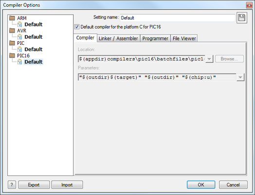

Compiler
Compiler location
Sets the location of the Microchip C30 compiler.
Default:
$(compilerpic16)batchfiles\pic16_C30_comp.bat
Compiler parameters
Adds command line parameters when called from Flowcode
Default:
"$(outdir)$(target)" "$(outdir)" "$(chip:u)"

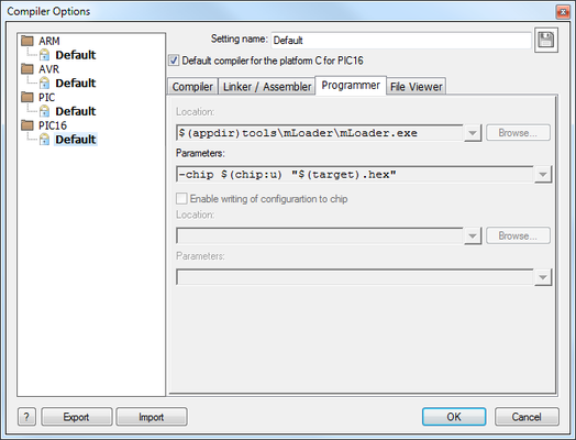

Programmer
Programmer location
Sets the Programmer application location.
Default:
$(appdir)tools\mLoader\mLoader.exe
Programmer parameters
Adds command line parameters for the Programmer application.
Default:
-chip $(chip:u) "$(target).hex"
