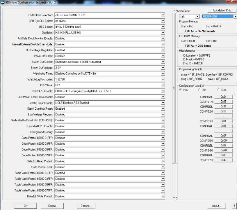

theese config words worked for me, with an external OSC 20Mhz, Flowcode V5;
config Words PIC18F4550 USB and external OSC.png (162.32 KiB) Viewed 2249 times
was succesfully recognised from windows 11 as universal USB Serial converter;
