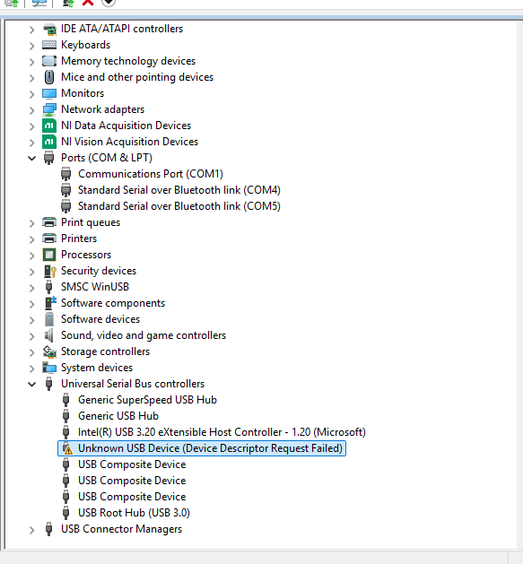

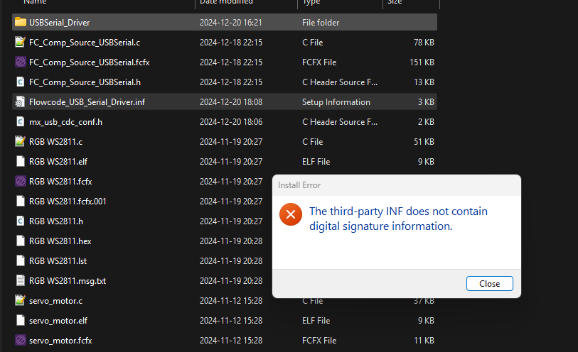

I developed a code for PIC18F4550 to connect USB serial to control the ports through Serial Command. But I couldn't install the Flowcode USB serial driver (.ini), and the Device manager shows an unknown USB. I installed the USB Serial Driver from the Flowcode Example page, but I still faced the same problem. Below is the picture. Please help me find where I made the mistake.

- Device manager.png (49.03 KiB) Viewed 3005 times
- signature error.png (59.48 KiB) Viewed 3005 times

The issue is with windows not excepting unsigned drivers.
There is information on how to install signed drivers but you need to that at your own risk.

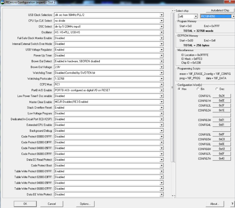

theese config words worked for me, with an external OSC 20Mhz, Flowcode V5;
was succesfully recognised from windows 11 as universal USB Serial converter;
