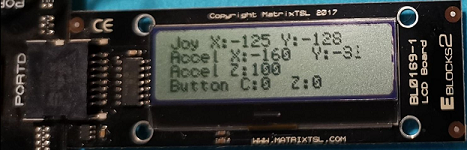

I have just created a nunchuk tester, so you can see if all is working or not.
Hardware:
Nintendo Wii knunchuck controller

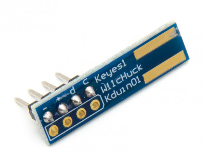

Keyes1 Wii chuck Kduino1 PCB adaptor for plugging in to nunchuck connector.
BL0080 Eblocks2 PIC multiprogrammer with PIC16F18877.
BL0169 Eblocks2 Alphanumeric LCD board 20x4 plugged in to D port of PIC multiprogrammer.
Solderless breadboard for PCB adaptor.
BL0161 Eblocks2 patch board plugged in to C port of PIC multiprogrammer.
DuPont jumper leads.
Of course this should work with any hardware as also tested with Arduino UNO.
PCB adaptor connections.
- to GND of PIC multiprogrammer.
+ to 3V3 of PIC multiprogrammer. Warning: Do not connect to 5V.
d to 0 of patch board (d = SDA).
c to 1 patch board (c = SCL).
Only the genuine nunchuck has currently been tested.
Will test the very cheap version (ranging from £2 on wards) as soon as received them.
When running the hardware, if all is working you should see this: Of course values will depend on the the orientation, joy position and if buttons pressed or not.

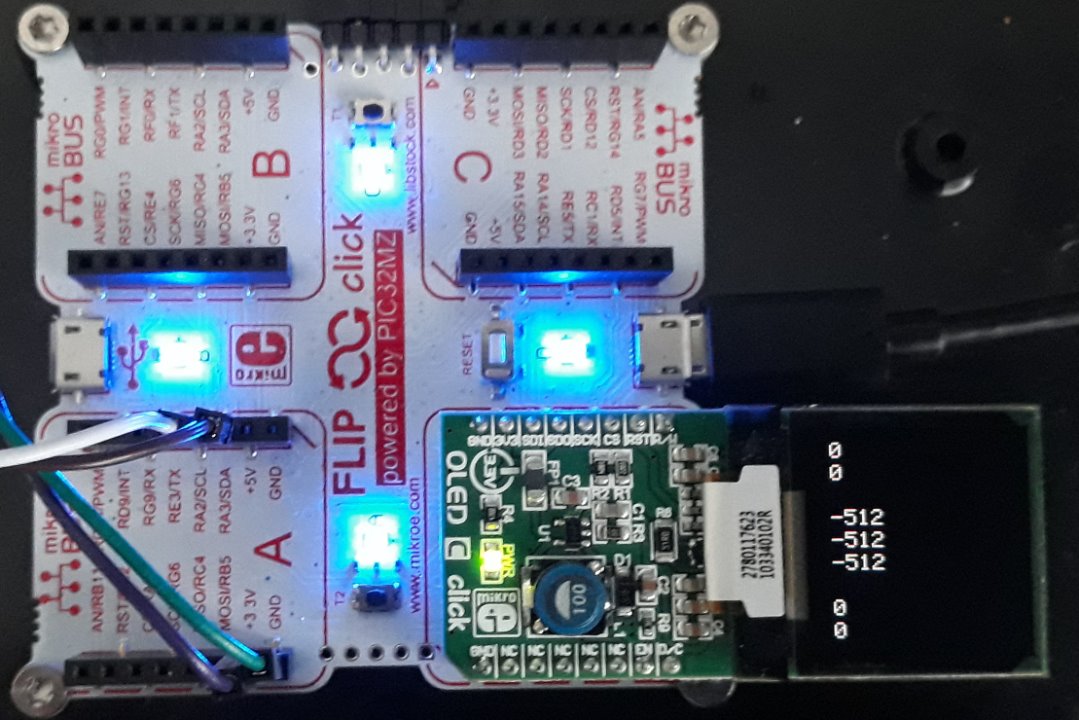

- Posts: 654
- Location: switzerland
- Has thanked: 182 times
- Been thanked: 179 times
Re: New Flowcode Wii nunchuck component.
Hi Martin
Yes the flashtest is ok.
I2C softwaremode:
The two switch are working. If I press one, the first and second value change from 0 to 1. The 3 Axis from Accelerometer are always -512 and the Joystick always 0.
I2C hardwaremode:
There is no clock on the SCL pin.
I2C softwaremode:
I2C hardwaremode:

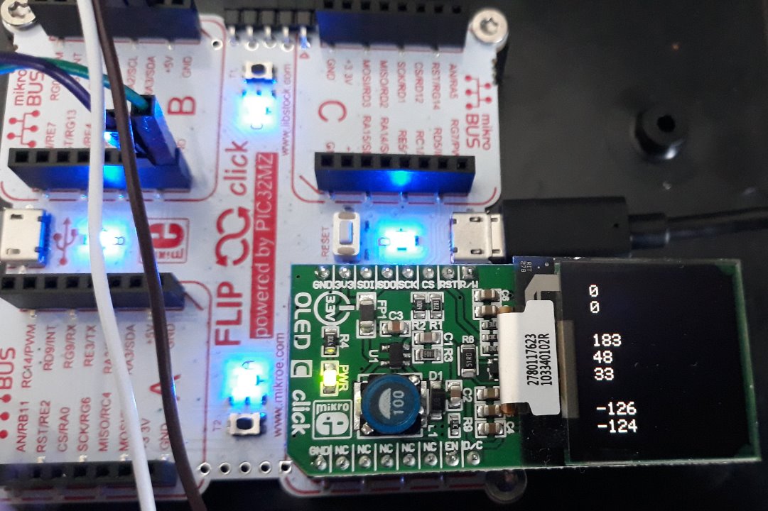

- Posts: 654
Hi Ben, Hi Martin
Is it possible to post where to shop working cheap Nunchuck?
There is a problem with hardware I2C and PIC32MZ.
But just in the 100khz and custom mode.
The 400kHz and 1Mhz are working in hardwaremode with the nunchuck.
The software mode is not working for the nunchuck Accelerometer and Joystick but the two switch are working nice.
