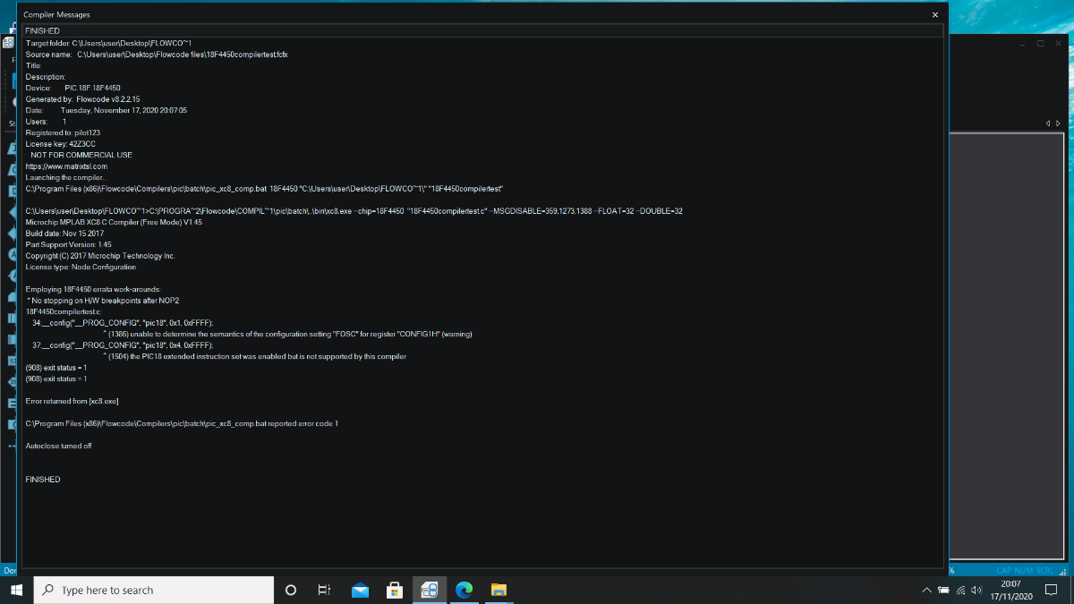

I have a basic license for 8 bit PIC, and BL0080 and BL0011 programmer boards. I have compiled programs successfully to the 16F18877 supplied with the boards.
I have written a program for the 18F4450 chip, but when I try to compile this chip I am unsuccessful. I have attached a screenshot,
could you please advise me how I can compile this chip?
Thanks.
Screenshot (4).png (173.13 KiB) Viewed 4649 times

Does your flowchart contain C code to set the oscillator settings?
― C.S. Lewis
Posts: 9521
Has thanked: 2585 times
Been thanked: 3815 times
Re: Compiler problem PIC 18F4450
The issues are within configuration settings i.e Build, project options, configure.
You will need select the correct oscillator type and change Extended CPU Enable to Disable.
You will be best going over all the options e.g Watchdog Time to disable etc.

Thanks for getting back to me.
I am not using C code to configure the oscillator, but I have disabled the extended instructions and watchdog timer, and the chip is now compiling.
I am still getting the following warning. ^ (1386) unable to determine the semantics of the configuration setting "FOSC" for register "CONFIG1H" (warning)
I will have another go tomorrow, when I have time.
Thanks again.

pilot321 wrote:
Tue Nov 17, 2020 9:58 pm
That issue I covered by
medelec35 wrote:
Tue Nov 17, 2020 9:17 pm
The default oscillator type is 15, which is nonsensical.
You will need to select HS,XT internal etc.
