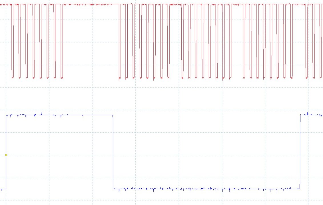

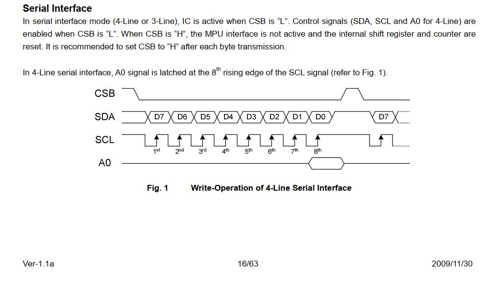

Re: Sitronix ST7586
The A0 signal should latch data on the 8th rising edge of SCL (see attached ST7586 datasheet excerpt).
Screenshot of oscilloscope trace shows in practice it only moves every 3 bytes.
Hope this is helpful info.
Clive
