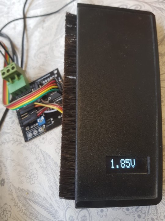

- WhatsApp Image 2022-04-07 at 7.44.34 AM.jpeg (63.01 KiB) Viewed 13271 times

Thanks again for your help, Martin!
I put the resistors as you said and everything goes very well, everything is linear! There are no differences in different voltages.
When you have some free time, can you explain to me why " * 5 " ?
Later edit: I think I understand, 5 is the ratio between the input voltage and the adc voltage, after the divider.
