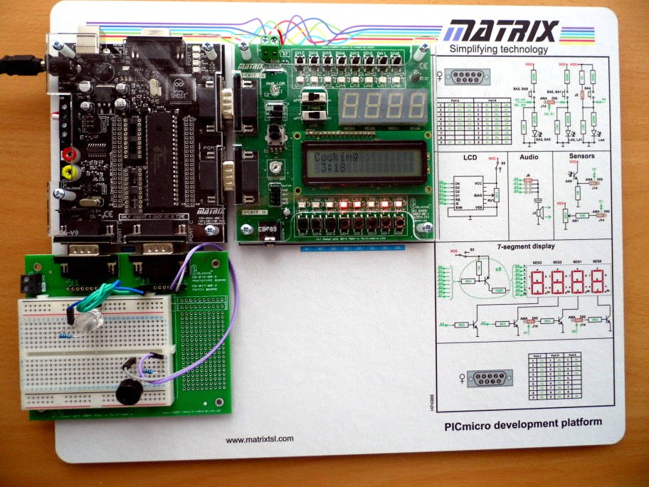

Re: BTEC Unit 6 - SAMs (the egg timer) Session 3 - Flowcode 7 software
This is the Flowcode 7 code for Session 3.
It's based on an earlier "hardware test" program with the LED and piezo sounder tests added for the egg timer.
Pressing keys SA0 to SA5, SB6 and SB7 cause the LCD to display their state ('0' or '1'),
Pressing key SB6 causes the piezo to sound, releasing SB6 silences the piezo.
Pressing key SB7 causes the big LED to illuminate, releasing SB7 turns the LED off.
If there's a bug that causes odd behavior later in the development cycle - this is the code to download to the board and make sure the hardware is still ok.
The key_task and Timer_2_ISR will be used without modification for the egg timer design.
The LED and LCD need tasks written to handle them as per the design.
main also needs quite a bit of work.

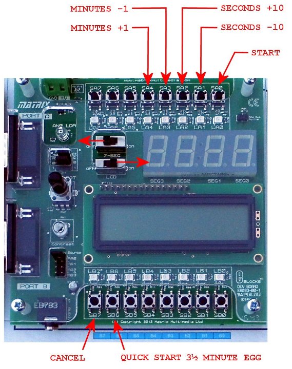

Re: BTEC Unit 6 - SAMs (the egg timer) Session 4
At the half way point it's starting to come together.
The "Quick Start 3½ minute egg" and "Cancel" keys work.
The LCD, LED and piezo sounder work as per the design.
The "SET TIME" and "START" functions will come in Session 5 and you can see the hooks where they fit in the Flowcode.

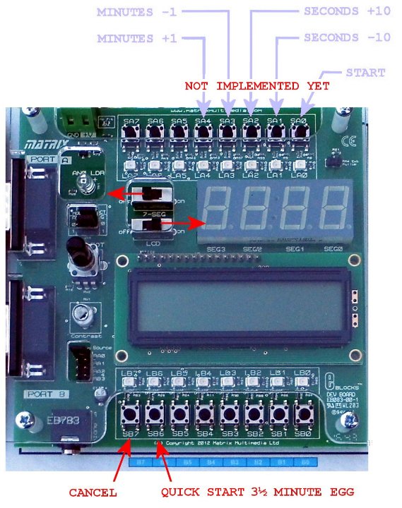

Re: BTEC Unit 6 - SAMs (the egg timer) Session 4 - Flowcode 7 software
At Power ON / Reset, you get the Welcome Message for a few seconds or until you press a key.
Then you get "SET TIME", but the only option you have there is "QUICK START"
Then you're "COOKING" until "DONE" or you "CANCEL".
If you let it run until "DONE", press "CANCEL" to silence the piezo and return to "SET TIME"

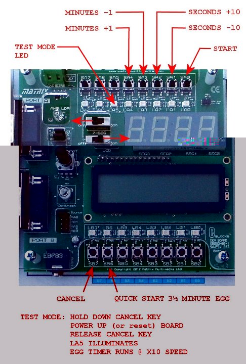

Re: BTEC Unit 6 - SAMs (the egg timer) Session 6
Just adding the fancy stuff now - overcooked and test mode up and running.
