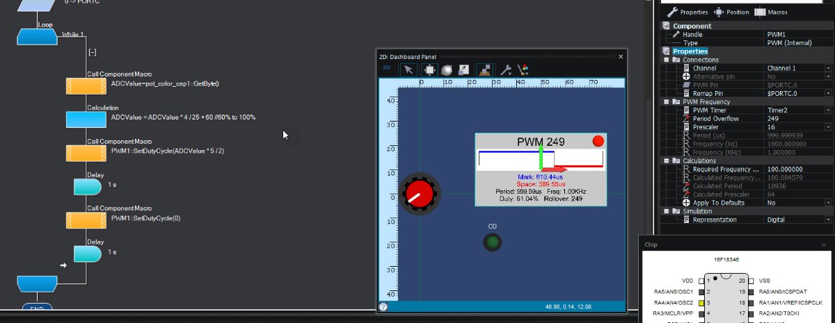

I have done it by this way. I will use CO, C1, C2 and C3 for PWM 1 to 4. The mosfets are also connected to these PIN's. This works great now with one mosfet on C0.

There is one more thing I would like to see in the flowchart. I can't think of this.
It would be nice if the LDR could be read once per minute and the average value calculated within a period of, say, five minutes. This value then goes to the variable ADCValue.
This is to prevent problems if, for example, five cars pass by when it is dark.
Of course, the LDR can be read once every five minutes, but an average of this is better.
I hope you understand what I mean.
