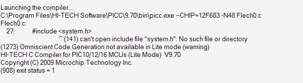

Could not compile the project on chip PIC12F683. The Same project on PIC10F206 was compiled normally. I have tried to restore installation from a disk, but also could not.
The compiler message

Re: problem compiling for 10F
Hello
I have just tried compiling a project for the 12F683 using the HITECH compiler on V4 of Flowcode and the program compiled correctly. Would it be possible for you to send me your file so I can find out what is causing your compilation problem.
Hello
Ok I see the problem it seems you are using a version of Flowcode that does not have the HITECH compatibilities built into it. In your generated C file it says you are running 4.2.3.58 which is the latest version that should have all the HITECH additions. However it seems that the chip you are using does not have this new information so maybe you are using a beta copy of 4.2 etc. We will be releasing an updated version hopefully this week that should tie up all these problems.
For now you should be able to replace the FCD file in your installation to fix this problem.
Let me know how you get on.

NOPROBLEM48
Posts: 30
Joined: Tue Nov 18, 2008 11:18 am
Post by NOPROBLEM48 »
Thanks! Your help has completely solved problems!
