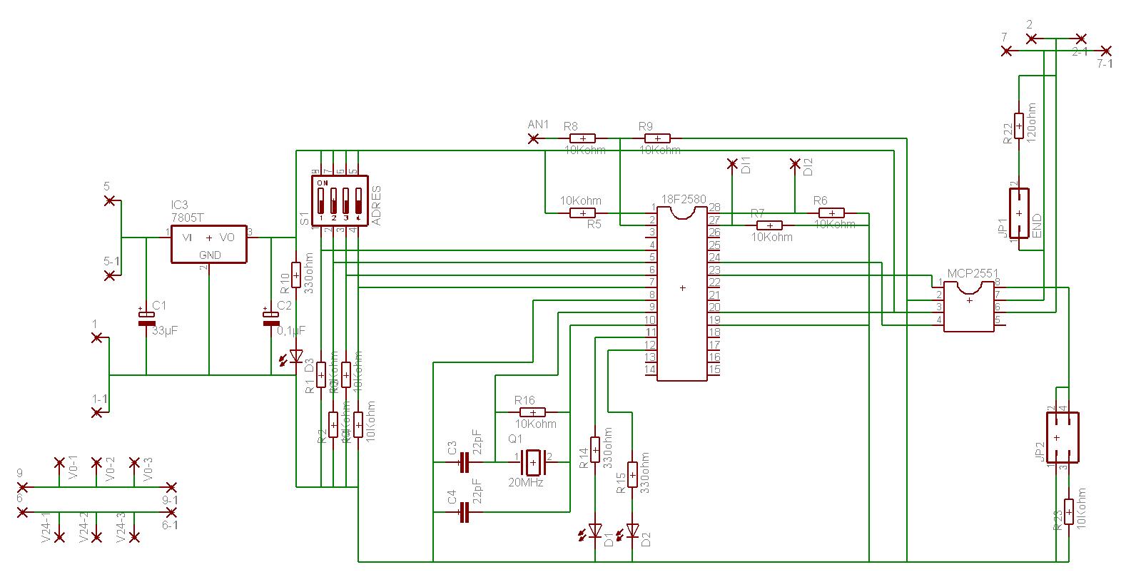

Dear flowcoders,
I have developed a circuit that works as a can bus node. Its a copy of a friend of mind and the program I have from works but not
like I want it to. So I bought flowcode and started designing. In the simulation everything works but when I download it to the PIC.
It gets stuck on Can Init. The problem is that flowcode still thinks i'm using the E-board via the MCP2515 and MCP2551. But that isnt
the case i'm only using the MCP2551 because the 18F2580 has a build in can-controller. If i go into the C-file i can also see the program
for the spi connection but as I said, I don't use the MCP2515 so I don't use SPI. Can this be fixed or I there a change that I can get it
right!!
Thanks!!
Georges
(Files in attachement)

Re: Can bus problem with 18F2580
Hello
Unfortunatley Flowcode does not currently support devices with an internal CAN controller. This may be resolved in the near future.
Hello
It should be possible to modify the functions in the CAN component C file using the Code customization in Flowcode v4 or by editing the component C code file by hand in Flowcode V3. Modifying these functions to use the internal rather then the external CAN controller should be possible. Most of the device registers should match up with the ones currently being accessed via the SPI bus.
