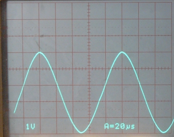

Second I tried the 2R-R ladder. I thought the PIC output should be buffered, but I figured out in the meanwhile that this can be deleted. But in the picture you will see two hex buffers (4010). And what was the fastest sinus I got? You see the answer on the scope picture. With the sinus generated in 256 steps, the frequency is just 0.1 msec, or 10 kHz.
Is that what can be expected? in the assembler program it can be seen that about 485 steps are necessary for 1 period of 100 usec. That means about 206 nsec per step. This is close to the official 203 nsec for an instruction cycle time with a 19.6608 MHz crystal.

It took much more time, but was very interesting. The sinus is not ideal. The reason can be easily found in the assembler translation of the flowcode.

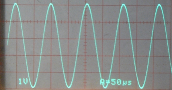

In the mean while I improved the 10 KHz sinus to a nearly perfect sinus. The deviation is 1:512, due to the fact that the loop makes the period of the sinus 1 programming step to long (1 period is in this particular case 512 programming steps).

FREQUENCY
The crystal used is 19.6608 MHz, which is 50.8 nsec. That means a program step will take 4x 50.8 nsec= 203 nsec. The period of the sinus is 513 program steps and that equals 104 usec or 9.58 KHz. And that is exactly what I measured with a frequency counter, see also the scope picture.
The first perfect sinus is possible with 3 program steps. The period time will be 203 x 3 x 256 = 156 usec of 6.4 KHz.
Of coarse other frequency are possible, by changing the number of step for one period. This has been taken in this example to be 256. But any number can be taken, if the accuracy is acceptable.
ACCURACY
E.g. if 25 steps are acceptable, 100 kHz sinus wave is possible. On the other side a very accurate sinus with 1024 steps and 3 program steps will have a freqency of 2.1 KHz.
