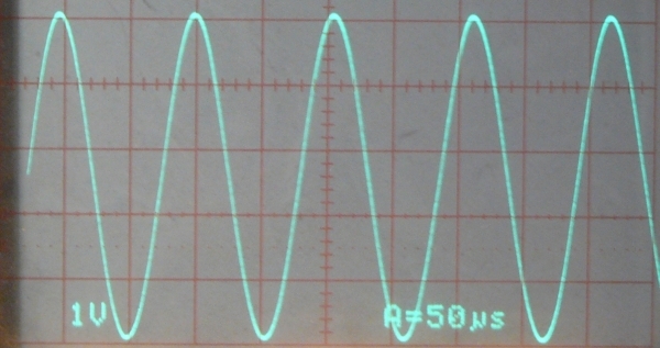

Second I tried the 2R-R ladder. I thought the PIC output should be buffered, but I figured out in the meanwhile that this can be deleted. But in the picture you will see two hex buffers (4010). And what was the fastest sinus I got? You see the answer on the scope picture. With the sinus generated in 256 steps, the frequency is just 0.1 msec, or 10 kHz.
Is that what can be expected? in the assembler program it can be seen that about 485 steps are necessary for 1 period of 100 usec. That means about 206 nsec per step. This is close to the official 203 nsec for an instruction cycle time with a 19.6608 MHz crystal.

In the mean while I improved the 10 KHz sinus to a nearly perfect sinus. The deviation is 1:512, due to the fact that the loop makes the period of the sinus 1 programming step to long (1 period is in this particular case 512 programming steps).
ASSEMBLER:
What I did, is deleting all stuff not essential in the assembler file.
In assembler, if the sinus changes value, 2 program steps are needed, while if the sinus does not change value, only 1 step is enough. To make that also 2 steps I put into the assembler NOP's which takes 1 programming step time, See asm file attached.
Translation into a hex file has been done by means of MPLAB and loading the hex file into the chip by means of PPP with the EB006 block connected to the PC. The hex file has also be attached. For details see http://www.matrixmultimedia.com/mmforum ... f=6&t=7825.
FREQUENCY
The crystal used is 19.6608 MHz, which is 50.8 nsec. That means a program step will take 4x 50.8 nsec= 203 nsec. The period of the sinus is 513 program steps and that equals 104 usec or 9.58 KHz. And that is exactly what I measured with a frequency counter, see also the scope picture.
The first perfect sinus is possible with 3 program steps. The period time will be 203 x 3 x 256 = 156 usec of 6.4 KHz.
Of coarse other frequency are possible, by changing the number of step for one period. This has been taken in this example to be 256. But any number can be taken, if the accuracy is acceptable.
ACCURACY
E.g. if 25 steps are acceptable, 100 kHz sinus wave is possible. On the other side a very accurate sinus with 1024 steps and 3 program steps will have a freqency of 2.1 KHz.
Using the R-2R ladder, own made, does have only an accuracy of 1% for each resistance which will decrease the anloge output accuracy. If better accuracy is wanted, commercial DAC has to be taken.
