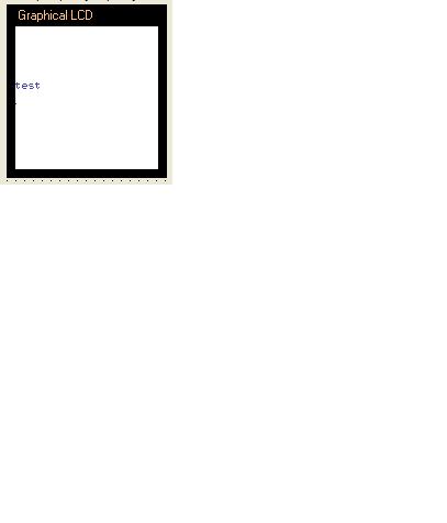

Thanks for your reply. I have looked at the explaination you have given me, of the new colour format, i was unaware of but is a great idea. However the problem i have also is that nothing displays correctly on the screen. This also includes on the simulator within flowcode. I have down loaded the flowcode example posted that displays the text "matrixmultimedia" and then prints a number. I have attached a screen shot of what i get in flowcode on the screen from the simulator "1.jpeg". I have also got a small flowchart that prints some text at 50,50 on the display. It places the text at 50 on the y axis but at 0 on the x axis. It also draws a box at 70,70 and ends at 80,80. However only a small is drawn on the left side of the screen. "2.jpeg" shows what the simulator in flowcode displays on the screen. I have also attached a copy of the flowchart the provides the results in "2.jpeg". Any help is most appreciated.
Zane

Hi Zane,
There is a simple fix for that.
See: http://www.matrixmultimedia.com/mmforum ... =29&t=8700
save PIC_gLCD.c update
There is information where to place the file.
That will solve the simulation issue.
