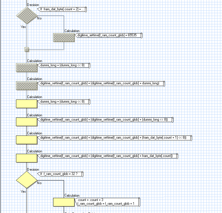

A long time I experiment a "long variable" e.g. ..settime[1] 99999 = 3 byte 159,134,1 in the F_RAM to save and build back.
I read back to the three byte-variable and want build the value 99999 back without success.
In simulation it work ok but on my hardware the value is (without the 1 = 65535) 34463.
If i go the way >> if....then it work on my hardware but show 99998
("0 to 0xffff" the code work ok)
Hope You can help
Nice evening and regards Wolfgang

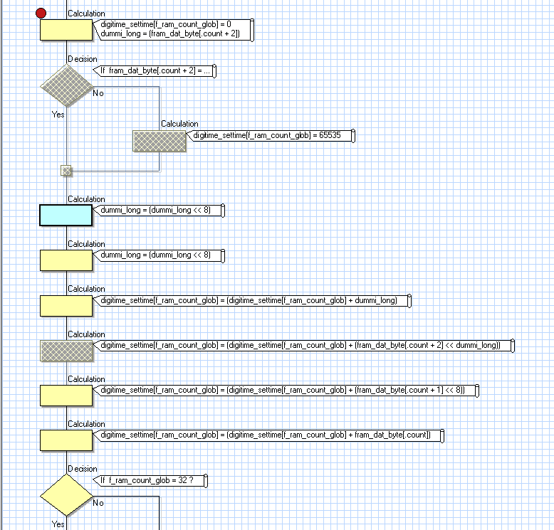

Hi Jonny
shift = 16
value = value << shift I test without success;show the same.
suggest for a new way,I do "dummi_long << 8" for two times and load with the result ; works fine on my hardware!
Thanks for your help!!!!!!
I test it two way`s it work also.....Hurra
Regards Wolfgang
1 time << 8 and 1 time << 8 inside the load line...
(30.04 KiB) Downloaded 1465 times
2 times << 8 than load
(30.19 KiB) Downloaded 1465 times
