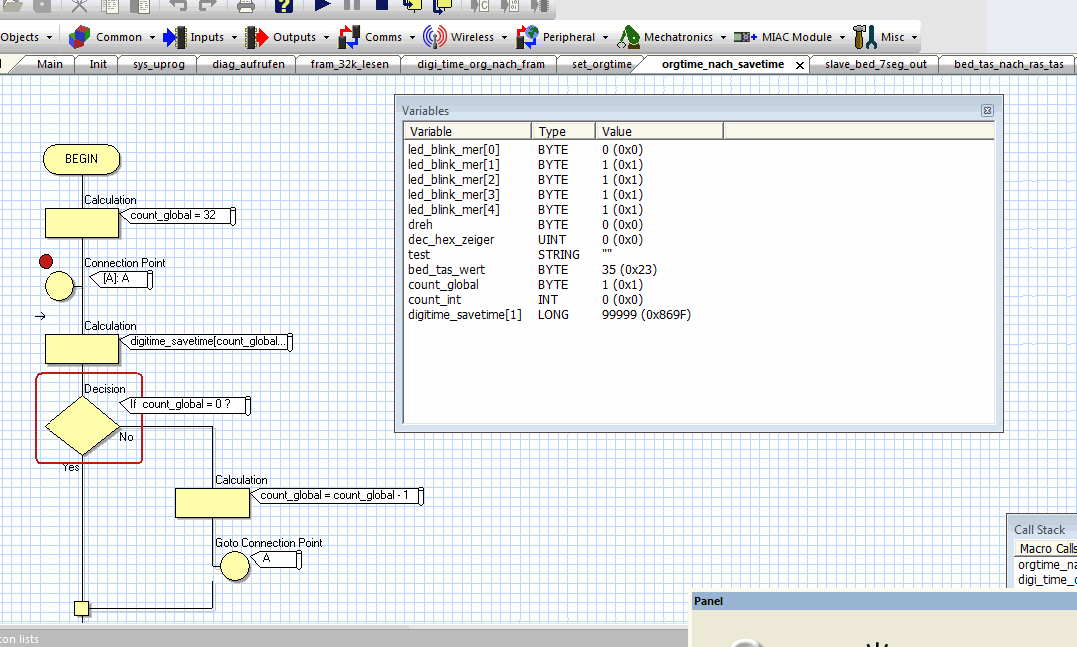

Hello
In simulation the (0x869f) is incorect >> (0x1869F)
Regards Wolfgang
long variable

Hi Wolfgang. Can you post your program for this please, or some sample code? It seems to be a 16 bit value that is displayed but I cant get any code from the annotation in the screen-shot.
It might be a problem with the variable view, possibly?

Hi Wolfgang. The error is a cosmetic one in the debug variable view window. The decimal value should be right but the hex is cropped to 16 bits. This will be fixed int he release.
Cheers,
Jonny

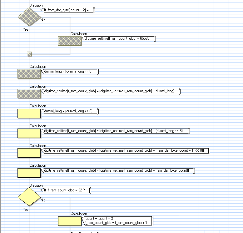

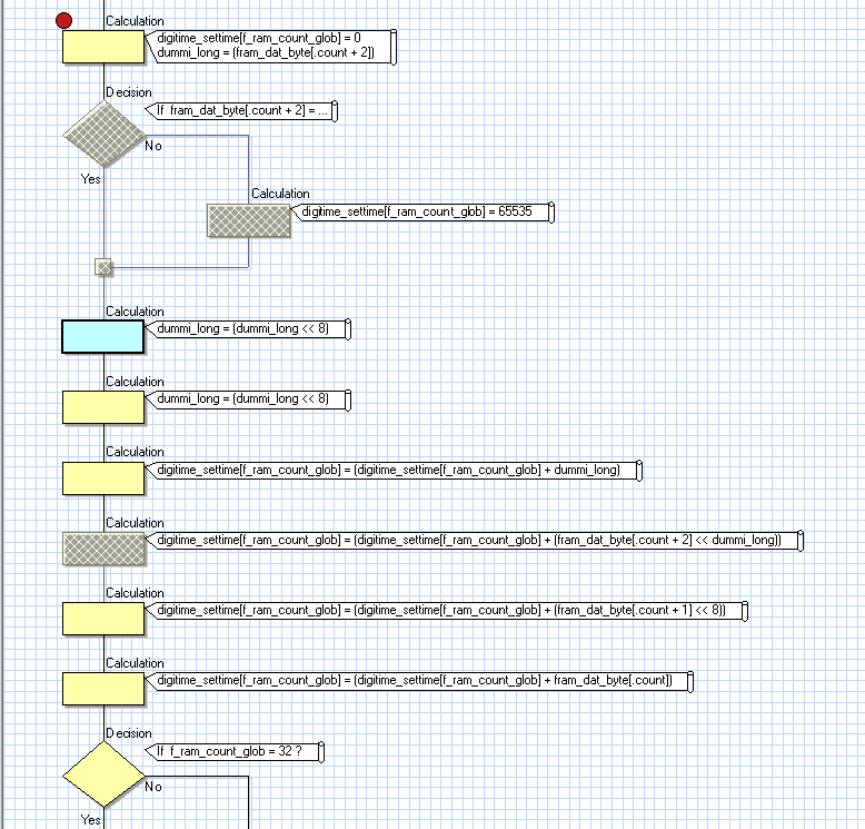

Hi Jonny
shift = 16
value = value << shift I test without success;show the same.
suggest for a new way,I do "dummi_long << 8" for two times and load with the result ; works fine on my hardware!
Thanks for your help!!!!!!
I test it two way`s it work also.....Hurra
Regards Wolfgang
shift = 16
Regards Wolfgang
- 1 time << 8 and 1 time << 8 inside the load line...
- (30.04 KiB) Downloaded 1465 times
- 2 times << 8 than load
- (30.19 KiB) Downloaded 1465 times
