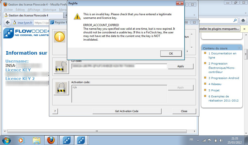

If I use a code from the code list as CD code, here is what I can see on my test computer
For information, Flowcode V4-50 concurrent users was activated on this test computer before this test.
I can give the Matrix team a code from the list in a PM if necessary.

The "test" licence number is OK on an old xp computer. Flowcode 4.3 was on this computer. I upgraded to Flowcode V4.5 then apply the number.
For the w7 netbook (not working on the previous post). I tried to uninstall flowcode, remove any flowcode or matrix key in the register and then install again. I am still unable to register (same error).
I will try the code on other computers.
Do you have a flowcode cleaning method or can you find anything else which doesn't allow flowcode to register on some computer?

Hi Ben,
No we dont have any Flowcode cleaning tool, but if you send another key to the student they should be able to use it, and then send that key to another student (essentially swap keys) as the computer has not seen this new key it should allow it to work.

Thank you.
The swap key method is working on that computer.
The "test" key can also register on a windows7 computer which have seen a site licence with flowcode v4.5.
