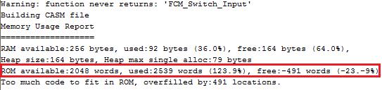

I was trying to see if I can take my code for the Scoreboard and try to load it into the PIC16F1826 and I have reach the cliff edge with another mile stone.
ROM Size Error - I'm not sure how to address this size issue - Do I need to delete code or do I find a new chip ?
i hope I can find a fix because I believe I have to add a few lines of Code outside of Flowcode and this might cause me problems.
Can anyone help explain my fix to this issue ?

You have overfilled the PIC memory and it has two solutions one is to use same pin-configuration PIC with large memory (easy but money consuming solution); the other is to customize the code to fit in the memory but that will be bit tough as 24% extra bit you have to modify or removed. So you can now choose which one you like to do..

You can select 18pins min and maximum: Then following microcontrollers will be displayed: As you can see the order shown is in order of memory size.
The only way of know how much memory code uses is do what you have already done..
Compile to hex.
Then rom usage is displayed as you have highlighted.
Just remember to divide value of rom shown by 1024 to convert to kbytes.
Taking your Flowchart and an example: ROM used = 2539.
= 2539/1024= 2.48K
According to datasheet for your device ROM =2K
Therefore you will require a ROM size of 4K minimum (Kwords).
