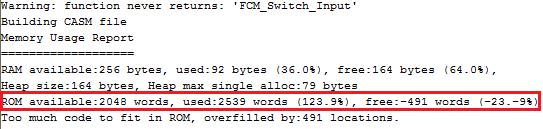

I was trying to see if I can take my code for the Scoreboard and try to load it into the PIC16F1826 and I have reach the cliff edge with another mile stone.
ROM Size Error - I'm not sure how to address this size issue - Do I need to delete code or do I find a new chip ?

Hi John
You have overfilled the PIC memory and it has two solutions one is to use same pin-configuration PIC with large memory (easy but money consuming solution); the other is to customize the code to fit in the memory but that will be bit tough as 24% extra bit you have to modify or removed. So you can now choose which one you like to do..

I was afraid that might be the case. Enamul can you recommend a new DIP18 chip it might be easier seeing I have the PCB being made for the PIC16F1826 ?
I will have a look at the program and see hat I can do.
Is there a way to see how much memory is in use ?

The only way of know how much memory code uses is do what you have already done..
Compile to hex.
Then rom usage is displayed as you have highlighted.
Just remember to divide value of rom shown by 1024 to convert to kbytes.
Taking your Flowchart and an example: ROM used = 2539.
= 2539/1024= 2.48K
According to datasheet for your device ROM =2K
Therefore you will require a ROM size of 4K minimum (Kwords).
