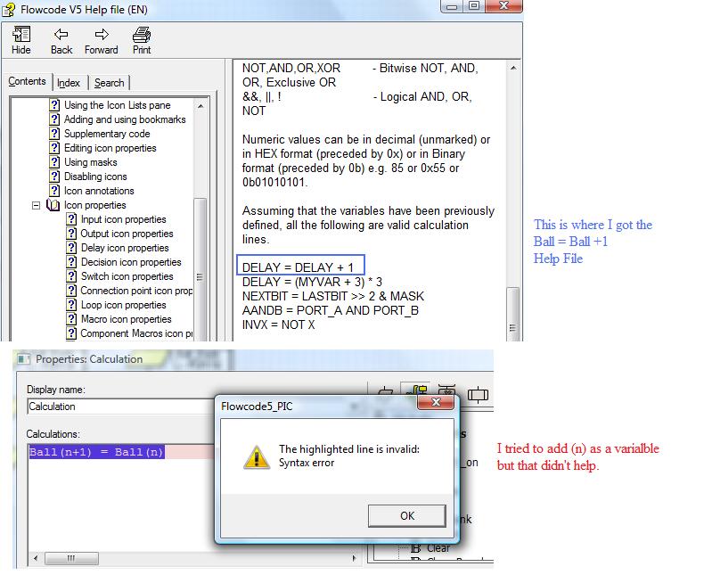

This error message is odd because the Value for Strike & Out don't appear to bother the program this is the odd thing I can't grasp.
Hope you can have a look at my project and see if I have anything more to fix. I would appreciate it.
John
Yes you are 100% right I was not sure how variables worked and could not find any course material so I used what I thought was logic that if you start with Ball = 0 and then Ball + 1 = Ball is like saying starting with 0 in Ball and adding 1 would place 2 in the ball variable.
Ball(n+1) = Ball(n) - So in this formula would be placed in the Ball Macro ?
Would I then make a Variable setting for N = 0 ?

Re: Activate PIC program
Well I thought I would try the Ball = statement with your Ball(n+1) = Ball(n)
Now I added it to the Marco Ball and it does not like it.
Did I enter the info in the wrong place ?
John
John
Hi. Apologies, I am not being clear. Your increment is fine - the 'Ball = Ball + 1' is valid code and increments Ball by 1. The 'Ball = Ball' does nothing - it increments Ball by zero.
I have modded your program to remove the redundant calculation icons. I'm afraid that things are too hectic here for me to go through your full program and amend anything else but your code looks pretty well organized and neat, which is a big plus when trying to find problems. Good luck with your code.
Jonny
Jonny

Thank you Jonny for you time.
I now see the flow where when it starts off Ball = 0 and once it enters the Macro it is handle at that point.
With you help I can see it running cleaner. Thank you for the compliment on the neat code when I don't know the code and starting with nothing. I suspect others could do a vastly improved layout but I can follow my thoughts.
OK now I just have to do some clean up of display to lower my ROM size in the current state I can not make a HEX file. My program is to big for the 16F1826.
All the best,
John
All the best,
John
