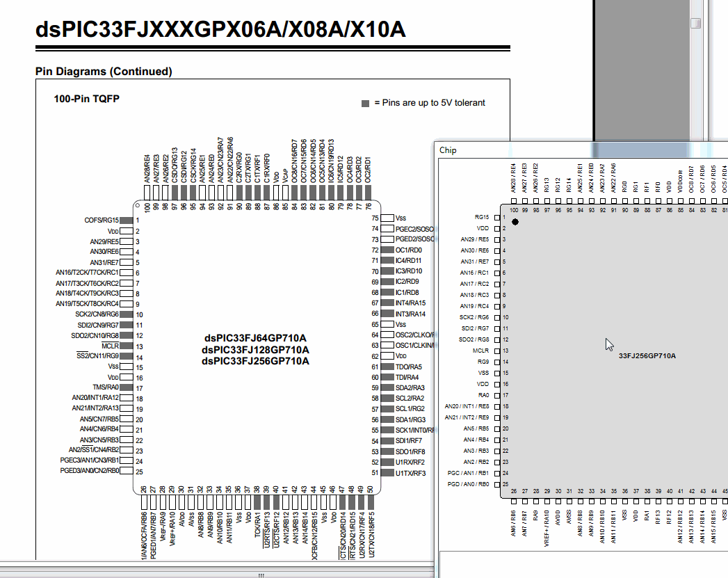

Hello
The dsPic33FJ250GP710A Pin names and port are not ok >> Int1 >> Int2
Regards Wolfgang
(78.2 KiB) Downloaded 397 times

Hi Wolfgang
attached is a corrected fcd
Dazz
33FJ256GP710A.fcd
(25.78 KiB) Downloaded 262 times

He,Dazz
Thank you
Regards Wolfgang
