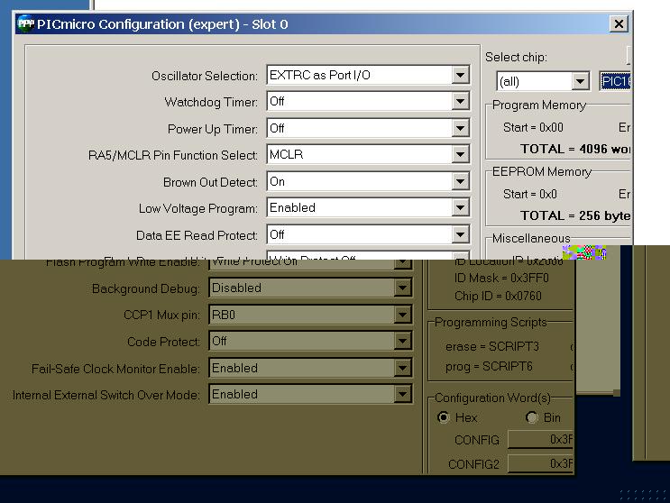

Thanks, but it does not work. Starting PPP3 gives error ''Failed to get data for CONFIG8L'
Ignoring starts the program, but the config screen is cut, so no buttons can be used.
However, programming,reading etc. is possible, but no chip configuration.

When you say you cannot see the OK and cancel button could you provide a screenshot of the issue as this seems like a similar issue we have had with another user, where their windows DPI settings were set higher (this makes all the icons and windows bigger in Windows bigger)

I donot think it is adpi problem, but an installation problem. As i said, i had v3.14 installed till it crashed. The version i received from you runs after unzipping.
Anyway, i attach the screenshot.
- Config.JPG (71.26 KiB) Viewed 39538 times

Looks to be a DPI problem to me, you can see that the standard font is larger then it usually is. You can view your DPI settings here in Windows 7.
Start -> Control Panel -> Personalization -> Display
and then more options available by clicking
Set custom text size (DPI).
Both of mine are set to 100% default.
PPP does not need to be installed, it is simply a set of files that run.
Clicking off the config onto a blank part of the PPP config window may allow you to hit the enter key on your keyboard instead of clicking OK.

Problem solved, however i have to use my glasses to be able to read the small characters in normal windows screens.
