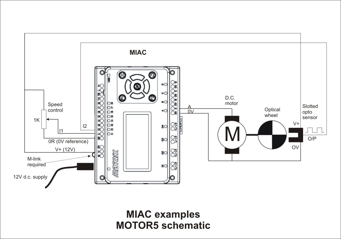

I found a example called motor5 which if you look at the JPG which is pretty much perfect although I wont be using the PWM for the motors but I do have a opto output from the actuators so I can measure the distance I am just using the ABCD ports as a H bridge which works well now. The interrupt for the opto is just what I was intending to do
The example is a flowcode5 one but I convert it to a V6 and it doesnt simulate it comes up with "array index out of bounds" and a unitialized variable
Here is the original file attached can anyone else please check that it will work as a V6 file. I dont want to use the pot for speed I just want to use a start button that will start a open sequence to a set distance and another button to start the close sequence there will also be limit switches on I1 and I2 just to make sure it will be all safe
Also attached is the current file that uses the red and green buttons on the Miac while you hold them down the motors move in the required directions but the lcd message drops in and out when going in either direction and I cant seem to be able to keep that up on the screen while holding the button down
- (97.32 KiB) Downloaded 12782 times

I have just looked at the motors example.
There is a bug so it would have never worked on flowcode V4, V5 or V6.
In the interrupt macro it shows
Yet isr_count variable is assigned as a byte:
So it will go up to a maximum value of 255 then after .
will roll-over to 0
To resolve this you will need to change the variable from a byte to an integer.
This is done by selecting variable in project explorer, then Edit.
After making that change PWM should work
