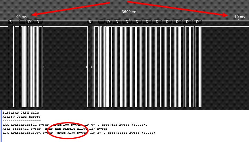

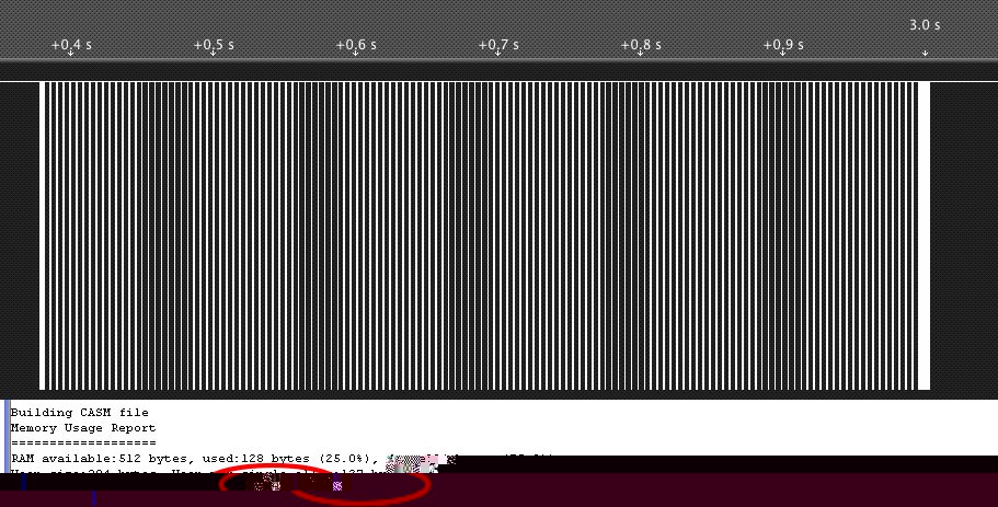

Hello!
The OneWire component is not working with DS18B20. I've created the same flowchart in Flowcode v5, and there everithing is looks fine. One other interesting thing: The v6 version needs double size program memory than the v5, while needs less data memory (not big difference).
I've tested the communication, the results is attached. With the version v6, the communication lenght is around 20 ms only.
DS18B20_test.fcfx
(5.39 KiB) Downloaded 335 times
