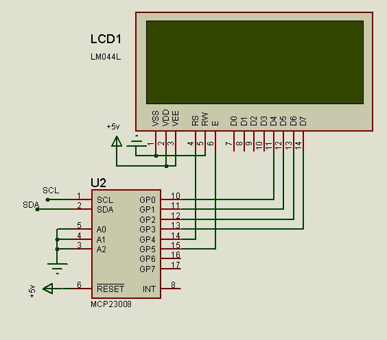

I tried for a long time to run a 4x20 LCD display with i2c in flowcode v5. I try to redo the above diagram and test but it still doesn't work. Is there a macro to flowcode v5? Could someone help me?
Thank you

Dan81 Hello and thank you for your reply,
I used the following flowchart. I have read and applied all the posts but it does not work.
is there a macro to flowcode V5 ? I used pic18F452.
