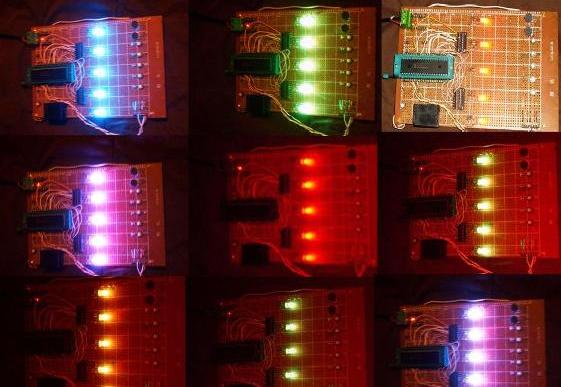

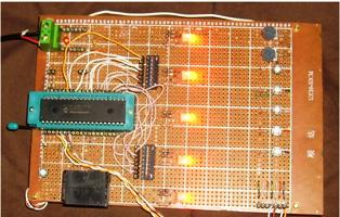

I guess I should have explained the circuit drawing. You should scroll down to the bottom of the circuit schematic drawing to the detail on how I made the "reset" and "button" inputs. I did not have enough room to draw them in full on the top picture so I drew them on the bottom. I based the pushbutton design from some demo board made by microchip. If i'm ever in doubt about a design element I look up a microchip demo board that has what I want and use the schematic from their board. The pushbutton circuit is working fine on the board I built. I am not a professional or any kind of authority on embedded circuits. If in doubt listen to medelec. He is far more knowledgeable than I on this subject.
I liberally use capacitors(.1uf ..'104'/small yellow..most of the time) to create a low pass filters. ( limits circuit noise and/or minimizes contact bounce from the pushbutton for ex.).
I have powered 5 rgb led's without any problems right from my 16f887, 16f877 and 18f4685. I suppose one of the benefits of using PWM and utilizing POV is that it minimizes power consumption. My entire circuit is powered from a modified moto. razr usb cell phone charger rated at aprx. 500mA/5v. You do not need a switching transistor to make this work for 5 rgb led's (=15 regular led's) as far as I can tell.
edit....here are a few pictures showing some the various colors and the board I built....
