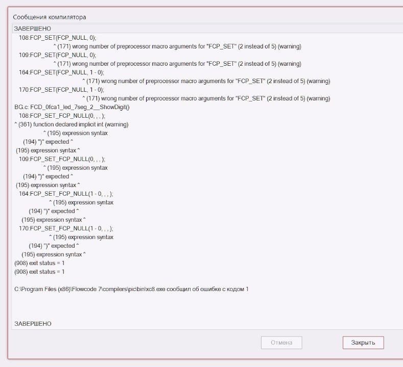

The display has connected 7 segments.
At emulation reports about a mistake
refuses to compile
refuses to compile

Osta wrote:The display has connected 7 segments.

As you have common pins 2 & 3 unconnected, flowchart will not compile.
You need to connect common pins 2 and 3.
If you only have x2 7seg displays instead of x4, then you need to use 7Segment(Single) instead of 7Segment(Quad).
If you can't find it then select search and enter 7seg

Thanks for explanation.
I have so thought too... To make such decision
i was forced by an opportunity in
settings the mode - "aren't included".
I have made just as you have told and everything works!!!
Control "isn't included" to me it is unclear... :(
