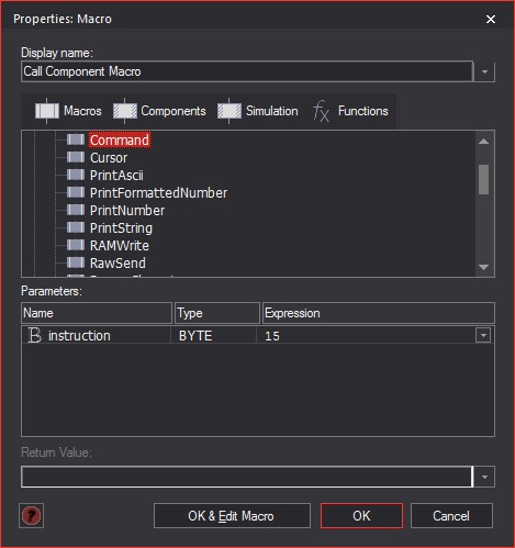

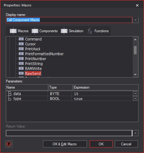

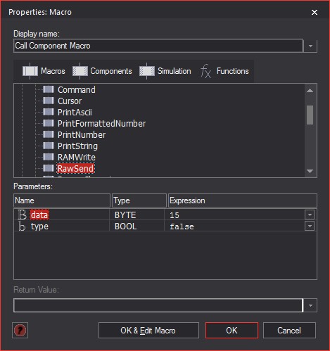

I've tried using the "RawSend" and "Command" methods of the generic 4x20 LCD component to no avail. Do they not work in the simulation or am I doing something wrong?
I've tried the following:
The results are all the same: No effect on LCD display (Can't turn display off, set blinking cursor, or turn cursor on/off)
