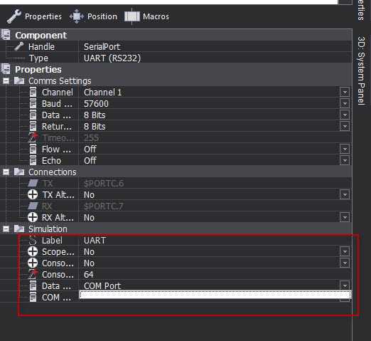

Hi Team.
I am unable to select the Comport in FC7 ,I tried the UART Component and the Hi Injector none allows me to select my ComPort
which is available and working correctly.
You will see if I use my terminal program I can select the ComPort however in FC there is no Port available to select.
Am I missing something here ,I would have expected when I click on the port in Properties the available ports will show up :oops:
I have restarted my computer a few times as I thought it will FC will refresh the ports
Any suggestions advise :D

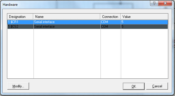

I see COM5 in my laptop when I connect my USB->RS232 adapter. Check in Windows Device Manager if the port show up correctly. If it's assigned to other application you can try to change to a spare one.

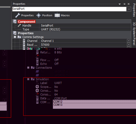

Re: ComPorts not visable in FC7.3
This could be linked to a Microsoft .net runtime issue. I was testing 7.2 with a clean windows 10 build and found that no COM ports were available. We then re-built our DLL libraries using the same runtime that Flowcode uses (previously 2008, now 2013 I believe) and this fixed the Windows 10 problem for us. We included these new DLLs in v7.3.
Might be worth trying to install the x86 versions of the .net 2008 and .net 2013 runtime to see if that helps things at all.
When moving to 7.3 did you do a fresh install or a patch? I wonder if the patch isn't replacing the DLL files correctly?
