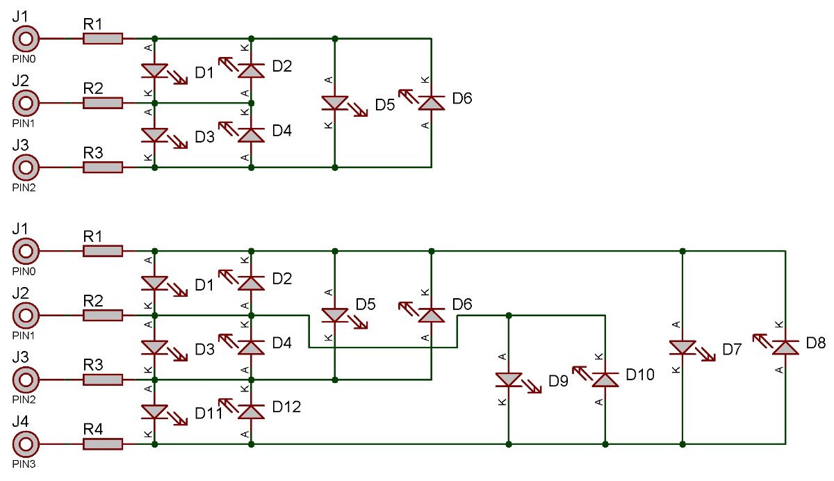

The other issue regarding this is how to match the hardware with software.
As I have chose 4 pins (12LEDs) I'm looking for a diagram which will match LED1 on flowchart with LED1 on a circuit diagram ect.
Can the diagrams with LEDs numbered and matching pins be added to wiki?
Re: LED Charlieplex Error
Thanks Martin,
I'll get something like this uploaded to the wiki.
I believe the rule is that the LED connections stay as was from the last pin count say from 3 pins to 4 pins and then add the extra LEDs starting from pin0 and working your way through.
Hi Ben,
I can confirm that the 4 pin 12 LED version works 100% on 12F1840.
The version I posted required 1ms delay in between each LEDOn component.
