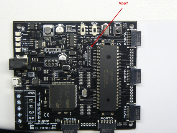

2. There is a jumper (J6) ICSP on the board which is very welcome! The question is which pin is Vpp? I guess the marked pin, see picture.

2) The marked pin of the ICSP header is pin 1 or MCLR/VPP.

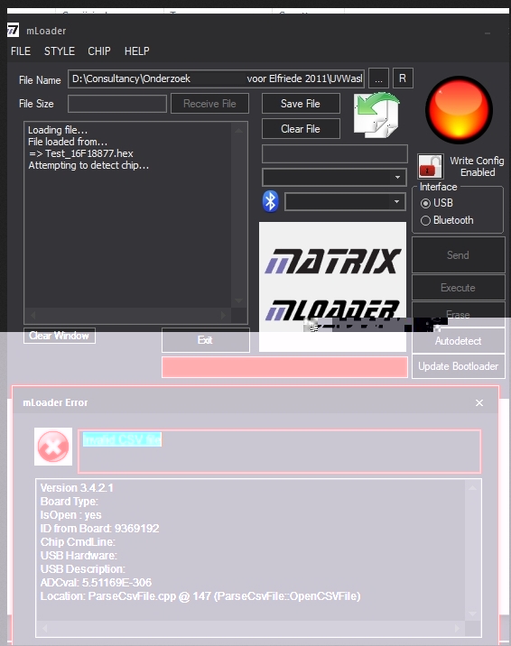

But I have now a real problem. Loading the (test) flowcode shows the device has not been detected. What to do?
I downloaded the USB driver. The USB of the BL0080 board has been install correctly (shows Windows 10). Both the original 16F18877 and the 16F1847 microchips show thesame result.

Can you confirm that you're using Flowcode 7.3 or at least have the latest mLoader installed into your Flowcode setup. You need the latest mLoader to be able to see and program the EB2 boards.
You can get a copy of the latest mLoader software from here.
http://www.flowcode.co.uk/old_site/resources/file ... Loader.zip
The mLoader version should be 3.4.2.1.

With a big lot of patience the installation of the patch 7.3 succeeded in 1 hour! I also loaded the newest version of mLoader. But unfortunately, the same result that the device is not recogniesed.
What to do next?

PS. picture of mLoader added

For the USB driver please can you right click the .inf file and select install. Or check in the Windows device manager that the driver is correctly installed.
The orange circle in mLoader should light up green when it can see the BL0080 board.
