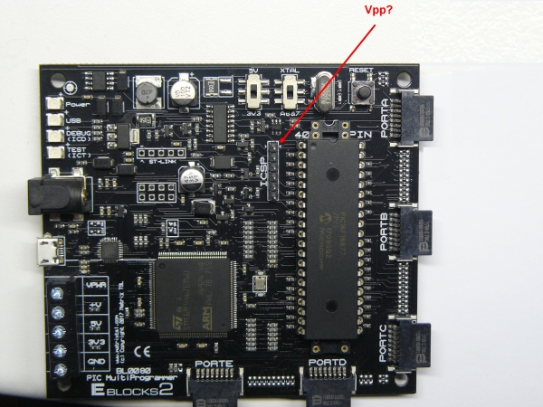

1. The crystal mounted is 8.000 MHz. The drwaing on p37 shows still 16 MHz.
2. There is a jumper (J6) ICSP on the board which is very welcome! The question is which pin is Vpp? I guess the marked pin, see picture.
3. A general remark. Without any manual it seems to me rather complitated for a starting person to use this board.
Kind regards
Jan Lichtenbelt

Re: Datasheet/userguide BL0080
Hi Jan,
No problem, glad to be of help.
1) The 16MHz crystal drives the host ARM processor. The other crystal does show a 19.6608MHz crystal at the moment so this does need changing thanks for the spot.
2) The marked pin of the ICSP header is pin 1 or MCLR/VPP.
3) The datasheet is a bit skin and bones at the moment and we hope to add more meat in the near future as we add more boards. There are already sections on reprogramming, ICD and ICT towards the end of the document, is there anything else you would like to see in there?
