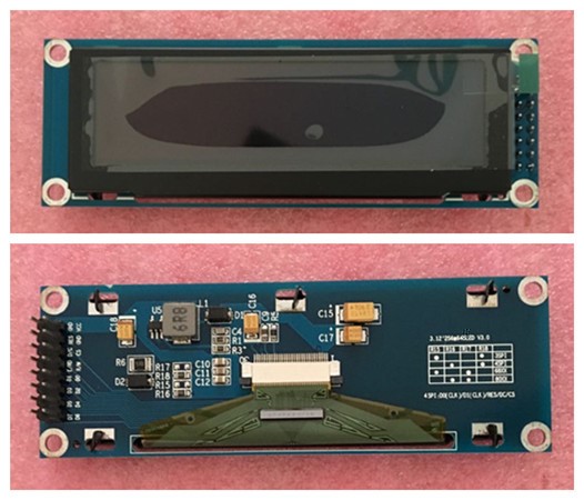

Attached you can find two programs, in bufferd mode and parallel mode and the photo of the display.

Hi Bruno
Control if the resistor are like in the picture.So you are sure it's 4pin. Connect the additional pin as in the picture.
If it's still not working, can you post a schema how do you connect it.Or a picture from your harware.

Thank you Stefan,
the display is in configuration 4pin SPI as indicatyed in the picture you sent me.

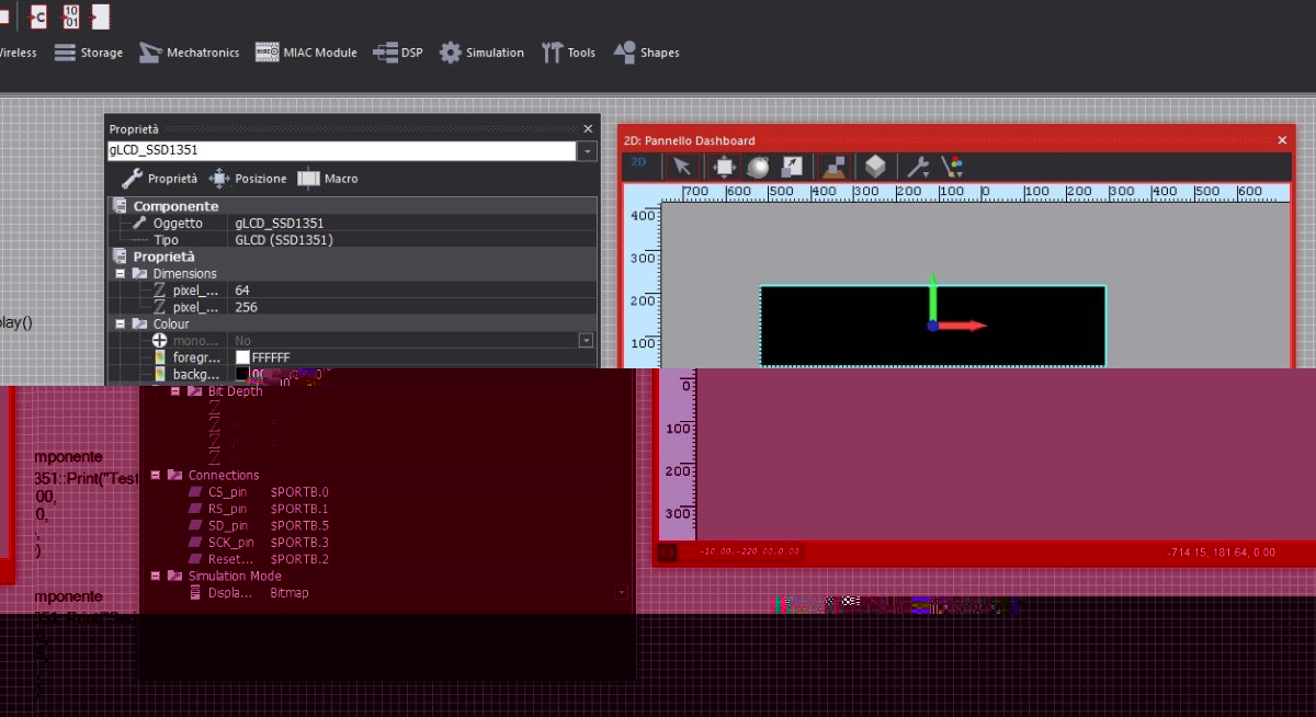

Thus, it works correctly with arduino connected with CS, D/C, SCK, DATA, Reset, as in the flowcode macro for the SSD_1351 component.
I think that the problem dipends on the absence of the D/C pin in your macro component for SSD_1322, as you can see in the attached screenshot.
I remind you that I am using a microchip pic 18f46k22.
Waiting for your answer.
Best regards.
Best regards.

Hi Stefan
I configured the display in 3 ways through the resistors, as shown on the board but still does not work.
As I said before, I have also configured the display in parallel mode, but even so it does not work,
I think there is a problem with initializing the SSD1322 in FC.
