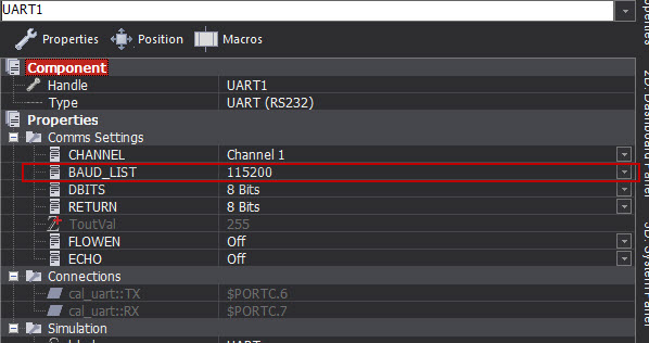

Looking at your Flowchart the baud is not set at 9600 it is set at 115200

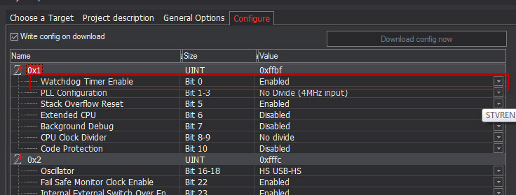

In general if you are not clearing the Watchdog timer you should switch it off ,this can cause you some strange errors I do not see in your flowchart that you clear the Watchdog
you should also make sure your Oscillator settings are correct this device has a tricky setup for the Oscillator as general info to a UART that does not work

I know the baud rate is changed, yesterday i was trying with it and forget to change before sharing it,

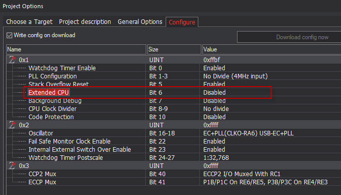

Try to Switch the Extended CPU instruction set off,
cubetronix
Posts: 11
Joined: Tue Oct 17, 2017 4:09 pm
Re: UART Issues
Post by cubetronix »
QMESAR wrote:Hi.
test-1.fcfx
(10.92 KiB) Downloaded 311 times
Thanks for the reply, after disabling the extended CPU UART is working but only TX, i cant receive anything with or without interrupt. kindly check the flowcode.
