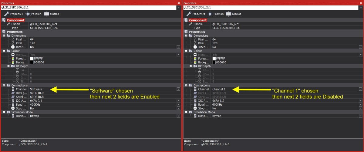

This is a general question about situations when we make a new component.
I have chosen as particular example the SSD1306 I2C display.
How do you set the Properties of the component, when you create the component, to be able to disable/enable fields based on what we choose in a list of a previous field?
Look at the screenshot below and please tell me how you do that:
Disable fields in Component Properties
