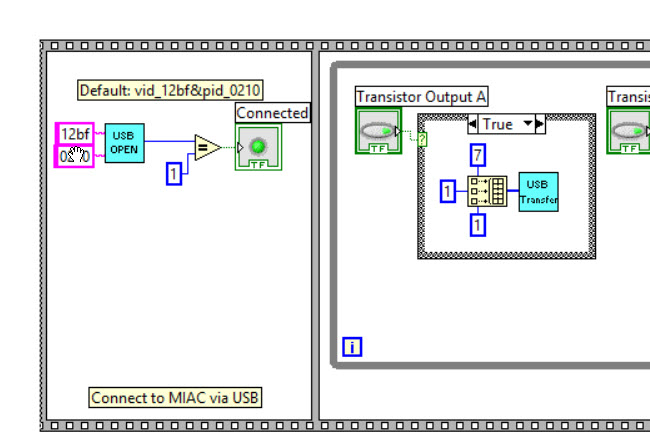

I set the PID and VID in labVIEW in the open USB sequence structure
(10.86 KiB) Downloaded 2829 times
Running the VI in Debug mode it shows the Open USB VI always return 0 any idea what I can do or should will be highly apprecaited

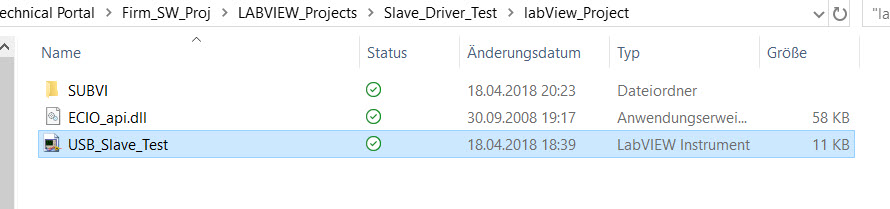

Please can you check that the "ECIO_api.dll" file is in the same directory as your Labview project .vi file.
It may be the DLL function is being called correctly but cannot be found?

The dll is in the same directory with the sub Vi as well.

After working a few more hours with this it seams there is a confusion with the VID and PID's in the drivers,
The MIAC when programming utility is used it used the 12BF and 0120 and it shows up in the Custom Devices.
when using the a PIC as a USB Slave the following is used 12BF and F030 ,
I have programed my MIAC with the MIAC as Slave Firmware from here http://www.flowcode.co.uk/webshop/miac-controller.html
however I do not see the MIAC then in the device manager , and the supplied firmware FC project does not compile
I am just not sure where to start with all of this which driver which firmware to use to get the MIAC connected as a slave and run from LabVIEW,

Please stop to waste your time the issue is fixed ,LabVIEW is running fine now and the MIAC does what LabVIEW command him to do .
Findings
(1) there are different PID-VID settings for the USB Slave and the MIAC Slave Drivers how come I do not know however as showed above the different PID Values.Not sure if there is any other hidden strings/numbers to tell the driver that it is a MIAC or a Normal slave device? but they are different drivers to the look of it.
(2)The MAIC Slave Firmware Project(FC) downloaded from the MIAC product page does not compile
(3) Downloading the same sourec files from the FC6 MIAC Wiki compiles correctly ,I then programmed the MIAC with this hex file and it showed up in the device manager with the correct PID and VID as also used by the LabVIEW open USB Vi.
(4) fixing the unconnected wires in the LabVIEW Transfer subVi remove the broken run arrow in LabVIEW
(5) Running the LabVIEW examples are working fine now
