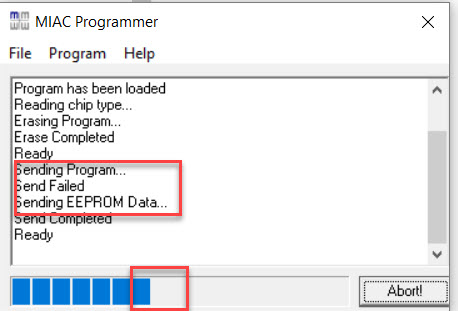

The MIAC Connects to the programmer load the hex file(which programs perfectly out of FC7 and FC8) then starting to program but then an error regarding the eeprom is made and the programming stops with the progress bar at the position as you see in the attached ,
What are we doing wrong ? On the other side it says sending completed I am not sure now is the MIAC programmed or not, as it is connected to a very expensive Test rig, I am afraid to start the system not knowing the MIAC is programmed Correctly

Can you try using mloader instead. Hopefully that should work correctly.
We switched the chip in the miac for a bigger rom size and the old software probably doesn't like big hex files.
