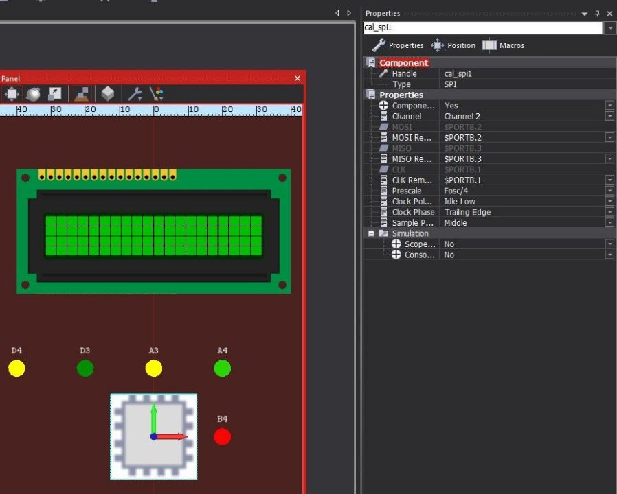

Hi everyone.
I try to establish SPI communication between a P16F18877 (master) and a Semtech SX1272-LoRa module (slave) without success.
I try to read the status registers but the Return byte is always 186d.
For example, when I try to read the register 0x42 which contains the Semtech ID revision number which is 0x22, the SPI read access returns 186d (0xBA).
I checked the SPI bus with the scope, and I have seen pulses on all 4 lines (MISO, MOSI, SCK, CS).
I have tried any possible combination of SPI component properties (clock polarity, clock phase, sample point) but the result is the same.
Could you check please if there is an error on my properties setting?

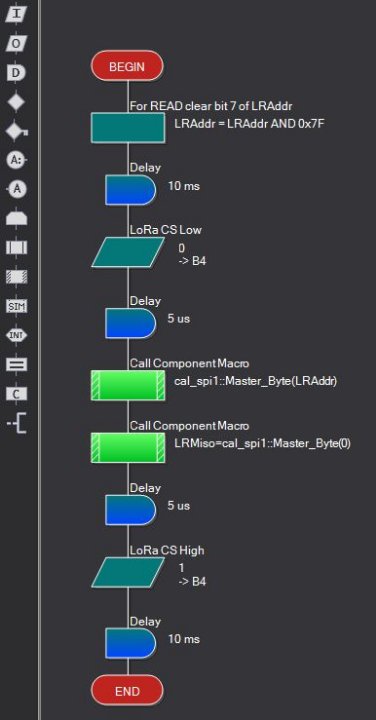

Attached is a small FCF with the SPI macros.
You could see the last SPI Write 0x01 to SX1272 OpMode Register (Address 0x01).
I try to Read it later and returns 194d (0xC2) instead of 1d (0x01).
The same applies to the Version Register (0x42), in SPI Read returns 194d (0xC2) instead of 0x22 (34d) which is the SX1272 ID silicon version.
If I try to read any other register, the return value is always the same 194d.
I use a 4X20 LCD to follow the values.
You should note that the SDO2 (MISO2) is mapped to RB3.
The SS2 (CS2) is mapped to RB4 while, by default is mapped to RB0. But the PPS (remapping) is executed within the Component Properties window?
Checking the actual hardware with the scope, the MOSI signal appears as High To Low transitions (so idle = High) while the MISO signal appears as Low To High transitions (so idle = Low).
I also checked the SPI channel 1 where is connected the other slave ATM90E32, with the scope. Here the things are inverted, MOSI Low To High transitions and MISO High To Low transitions.

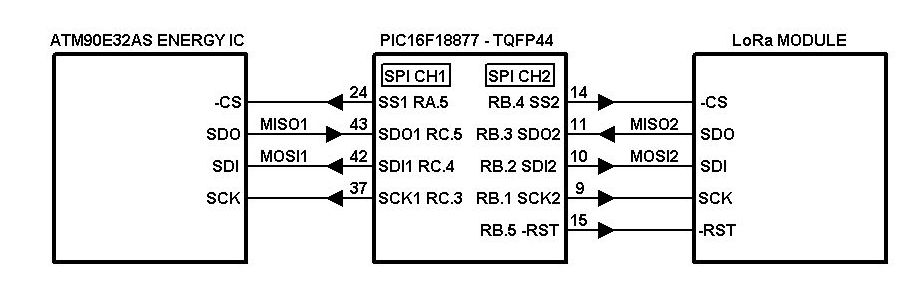

Here is a schematic of my hardware that could help you better?
It would be precious for me a confirmation that the SPI Channel 2 is free of bugs within Flow Code. Then, something is going wrong with the LoRa module, and I could make a question to RF-Solutions.
By anyway, thank you so much for your care.

MISO_2: RB.3
MOSI_2: RB.2
SCK_2: RB.1
SS_2: RB.4
Please note that in my hardware the micro used is a P16F18877 in TQFP44 package and its ports are allocated on different pins compared to PDIP40 package. Perhaps the problem arises from that?
Here the PIC16F18877 pin-port default mapping after reset:
              PDIP40 pin     TQFP44 pin
SCK_1(RC.3)         18                  37
SDI_1 (RC.4)         23                  42
SS_1 (RA.5)           7                   24
SCK_2 (RB.1)         34                   9
SDI_2 (RB.2)          35                  10
SS_2 (RB.0)           33                    8
SDO_1 (RC.5)        24                  43     (Is not mapped by default, it is PPS remappable)
SDO_2 (RB.3)        36                  11     (Is not mapped by default, it is PPS remappable)

I found bug and in SPI CH1.
Just to remember that we talk for the P16F18877.
The CH1 is working flawlessly with the following component properties:
MOSI = RC.4
MISO = RC.5
SCK = RC.3
This is not the default mapping of CH1 after reset.
I exchanged the mapping of MOSI - MISO and now the CH1 present bug:
MOSI = RC.5
MISO = RC.4
SCK = RC.3
This is the default mapping after reset.
Then, I mapped the CH1 to the default pins of CH2:
MOSI = RB.3
MISO = RB.2
SCK = RB.1
It presents bug
Exchanging the MOSI - MISO mapping also presents bug:
MOSI = RB.2
MISO = RB.3
SCK = RB.1
I'm pretty sure that the remapping (PPS functionality of P16F18877) is incomplete and contains many bugs.
Could you take care of it, please?
I'm in waiting for the 4th day.
I have to debug a big FC LoRa TX-RX code!
Thanks :D
Best Regards FOTIS ANAGNOSTOU

I have been checking the C code for the remap against the datasheet and all looks OK so far.
If the issue is blocking your work, could you try setting software SPI mode in the component and continue with that for your LoRa testing for now?

You should not need any C code.
Just set the SPI properties to
Channel: Software
MOSI: $PORTB.2
MISO: $PORTB.3
CLK: $PORTB.1
